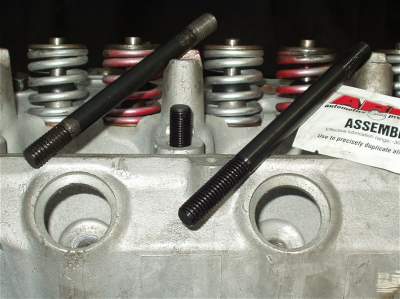

Hoping this will seal OK and make 225-250 HP. You using ARP head studs? What torque on the bolts (or nutz)?
Looking forward to more Buster reports...
PostPosted: Fri Aug 28, 2009 8:54 am
Posts: 4880
Yes, ARP studs / nuts that I currently have torqued to 55 ftlbs.
The special aluminum block head gasket received a light coating of Copper Coat spray sealer right before it went onto the engine.
I will start the engine and give it a short heat cycle, then check head stud torque, at 55 ftlbs.
Restart the engine give it a few more heat cycles, as I tune it and re-adjust valve lash, recheck all bolts, etc. then see if I can re-torque a little tighter, may-be get to 60 ftlbs. We just have to "get there" and see how it feels.

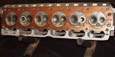

Are the Alum head gaskets a "steel shim" type or a composite. I have seen alum blocks before but cant remember a head gasket. How long do these gaskets last?
Frank
73 Duster - Race Car
66 Dart Wagon - DD
178" FED
82 D150
All Slant powered
PostPosted: Sat Aug 29, 2009 8:42 pm
Posts: 3740
Location: Sonoma, Calif.

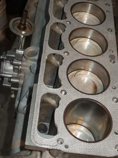

The aluminum SL6 head gasket is a special composite gasket.
It has a perforated steel core, sandwiched with an asbestos composite, then a solid copper sheet on the block side, the copper is rolled over to the head side to make a double thickness copper fire ring, around each bore.
The shape difference can be seen in these photos, the gasket extends out into the lifter gallery which follows the shape of the open deck aluminum block. A cast iron block head gasket is straight across in the area and leaves a gap, letting water thru.

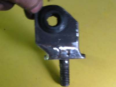

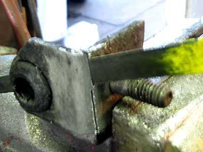

I knew the engine set-back decision was going to slow down this job and I was right. :roll: :cry:
The bellcrank for the shifter was tilted to the rear and a bit low so I had to do some "modification" to the bracket the holds it onto the bellhousing side.
My hacksaw and arc welder made fast work of moving the bracket's eyelet into the correct spot and now the shift linkage is hooked-up. :D

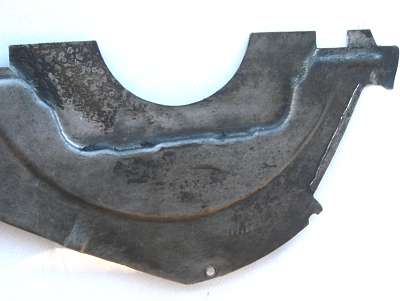

Here is a good tip...
I alway cut-out the two thru holes in the front trans. dust cover. Doing this modification allow the cover to be removed and re-installed, with-out removing the two bolts holding the support bracket. Basically, the notched shield slips-in, around the bracket and the two small, lower bolts hold it in place.
PostPosted: Sun Aug 30, 2009 7:13 pm
Posts: 17621
Man, I don't remember the last time I used one of those covers on one of my cars - 1992?
I expect nothing less from you, Doug!
PostPosted: Mon Aug 31, 2009 9:48 am
Posts: 4880
My Dacuda is so darn low to the ground, I worry that the flex plate / converter assembly could "scoop-up" unwanted roadway items... so I run the cover.
Some argue that leaving the cover off helps converter cooling but have have no info to back-up that claim.
