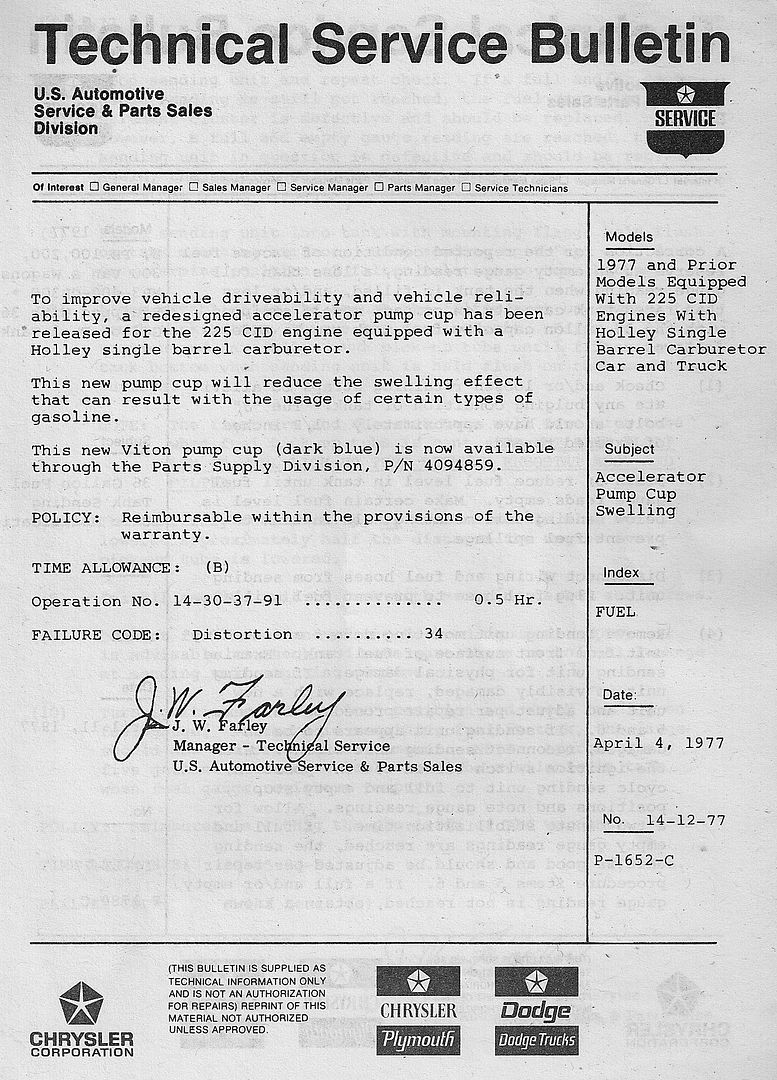

Can anyone tell me why this thing eats accelerator pumps and why the stream is always terrible at the start of the stroke? Seems like every 2 months I'm putting a dang pump in and they always rip on the top edge of the cone. They feel like they fit tightly down the bore for the pump until about mid-stroke, which is when they feel to loosen up. I've tried soaking them in brake fluid, wrapping a small spring under them to baloon them out (that didnt work at all), etc. But the stream is always weak and sputtery at the beginning but then is nice and healthy the rest of the way.

https://buy.walkerproducts.com/carburet ... nents.html

Call mike on the phone and ask him about this. It been years but these things swell up from todays gas. Get 2 of both sizes, see which works best. Mike is walker dealer and very helpful .One thing for putting it back together,take a hair blow dryer and warm the bowl ,and put top section in freezer.It will go back together this way, if using cup that has been in gas.New cups will usally drop right in .

By now should be some thing better than viton

Today's carburetor parts are made of materials compatible with today's gas; that TSB is not applicable because we don't live in 1977 and we aren't shopping for 1977 carburetor parts.
The most likely culprit is a rough spot or sharp edge in the accelerator pump cylinder that's tearing the cups.

I normally have to slowly work the new cups in for the accelerator pump with the aid of WD-40 or the gas left in the bowl (had to do this more than once with the carb on the car). They are always a super tight fit but feel ok moving them after they are installed. They only feel "loose" when they begin to move a bit more freely somewhere around the middle of the bore. I have used kits from HyGrade, Walker, GP Sorenson, and a different generic kit. All of them include the dark blue rubbery cups for the accelerator pump. And somehow they all rip. I'd like to THINK they are all the same size but....I frankly have no idea because I've never held them up side by side to compare them.
