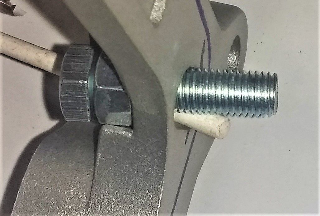

Supplied bolts almost useless no washers slip right through

Author:  matv91 [ Wed Jan 13, 2021 6:16 pm ]

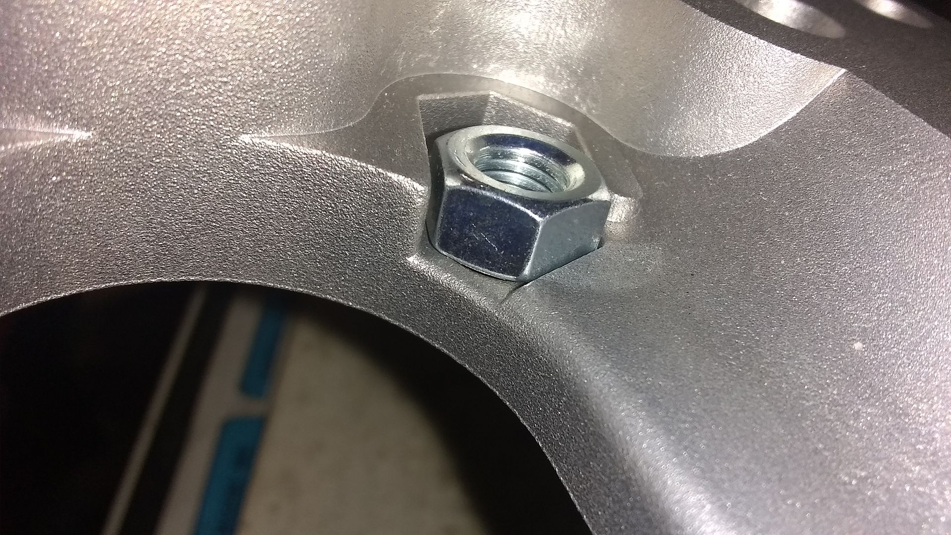

Post subject:  Re: Tuning a Carter AFB 9501 for a stock 225
That nut fits in there pretty good, much more surface area. Drill the threads out of the nut so that a separate bolt can be used
Author:  matv91 [ Wed Jan 13, 2021 6:20 pm ]
Author:  Reed [ Wed Jan 13, 2021 6:25 pm ]
I like your solution. Very nice.
