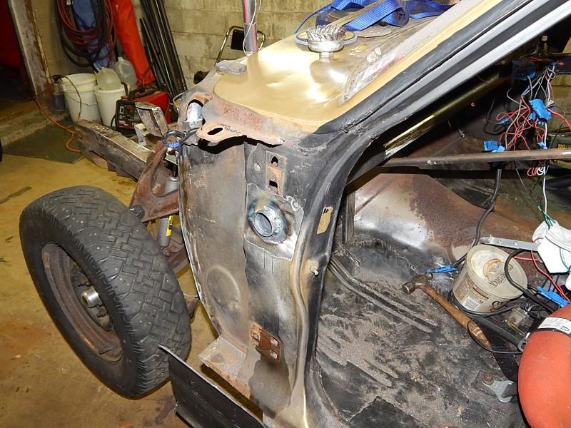

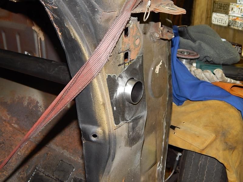

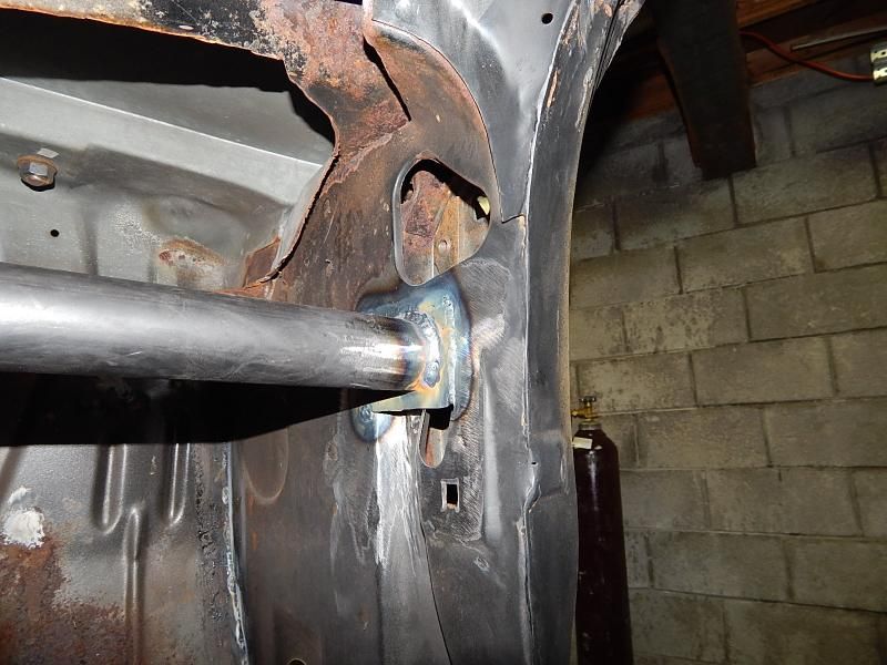

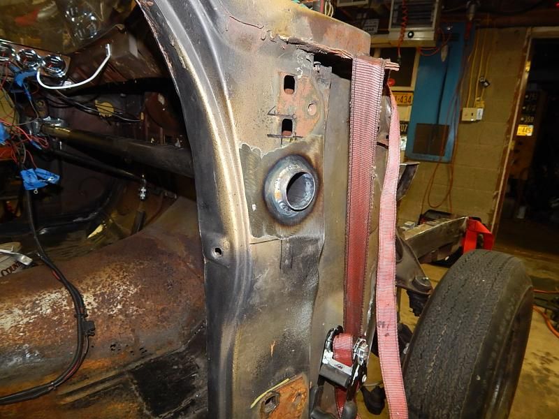

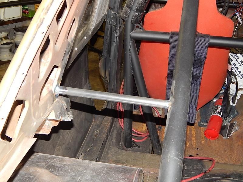

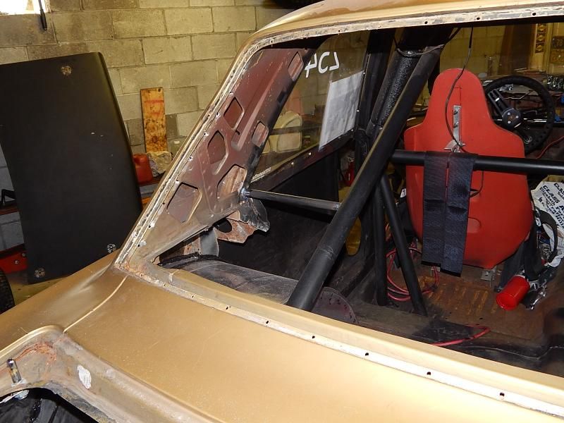

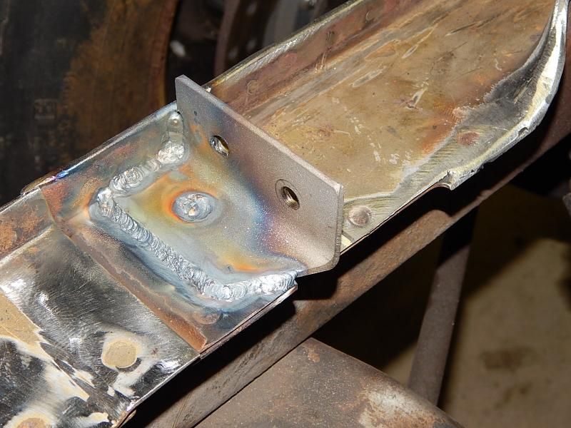

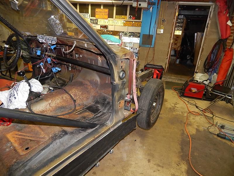

I finished the Rear Wheel Tubs and Created a Template to Get the Wheel Well attached to the Existing Quarter panel without rivets, welding etc.

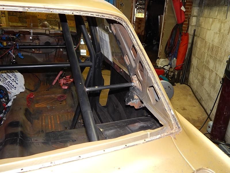

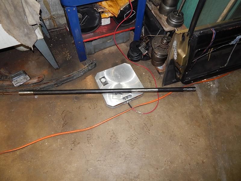

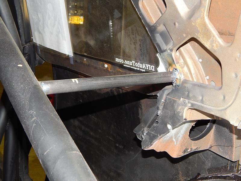

I also Was able to Fab up some 3/4" Thin Wall 4130 Tubes to connect the "C" panel to the Rear Struts of the Roll Bar. (thanks Seymour for the Tubing Donations)
Now the Quarter panels dont flex and bend when I try to push the car or lean on the Panel.. They needed some reinforcement after trashing the package tray, The rear X brace and the Rear Wheel houses.

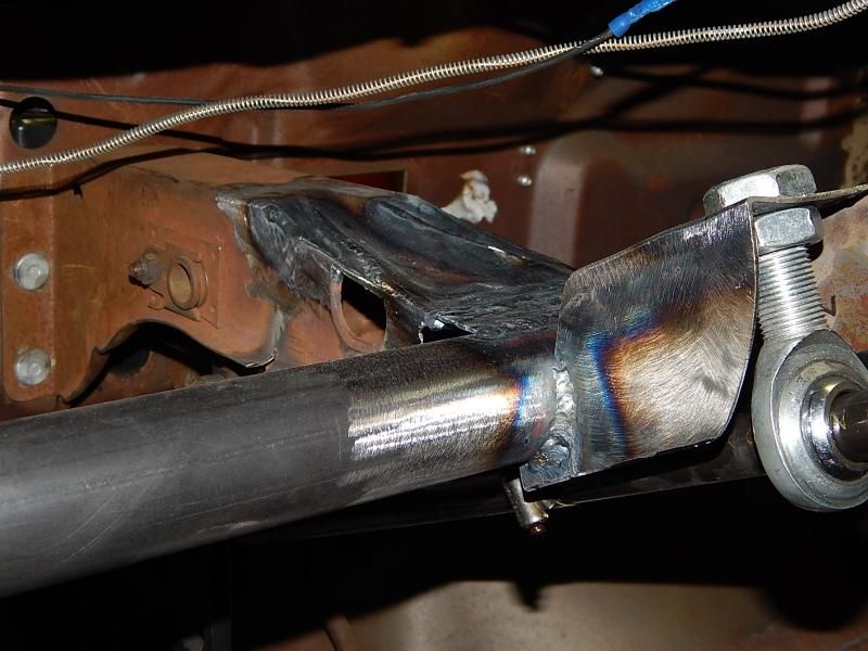

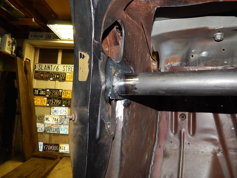

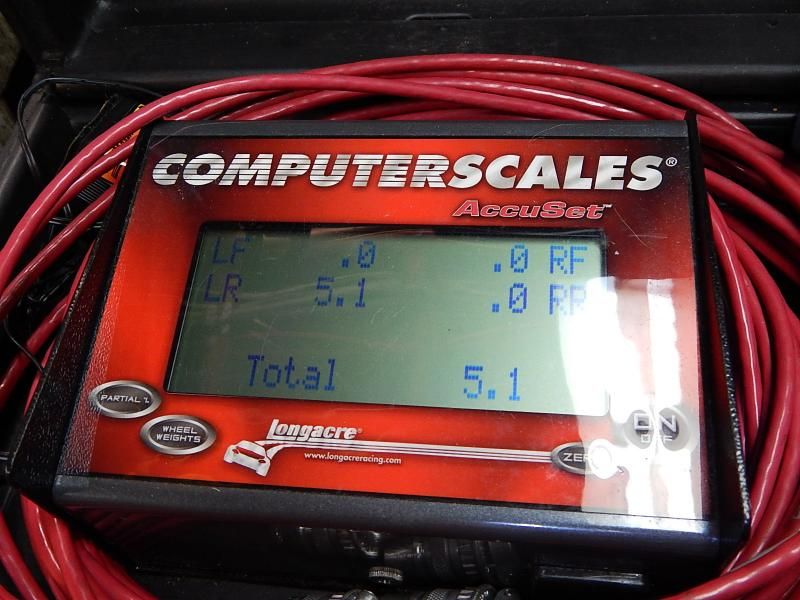

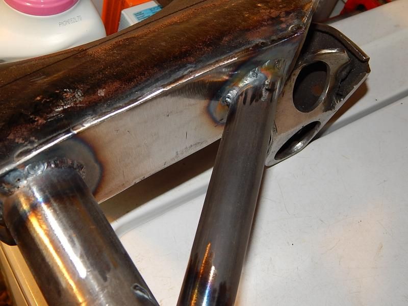

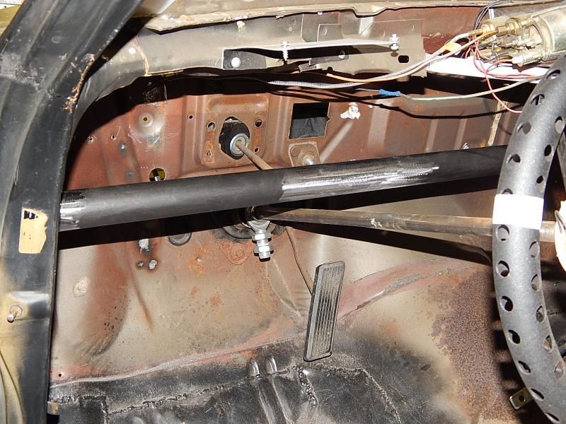

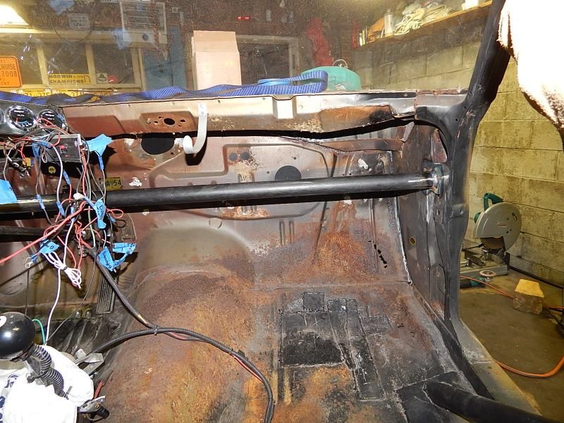

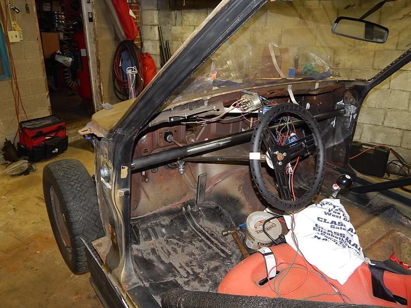

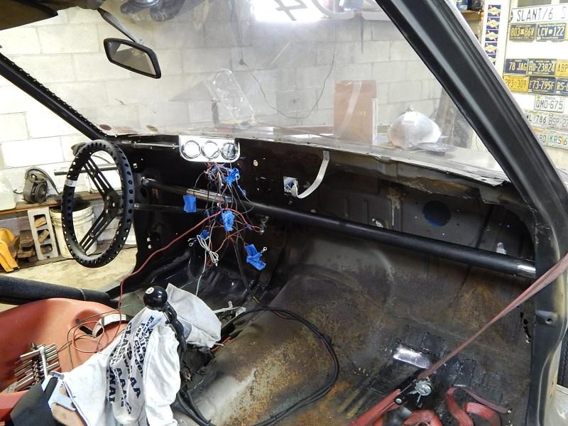

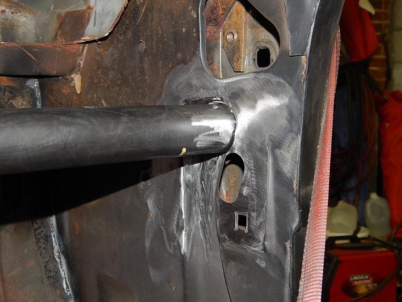

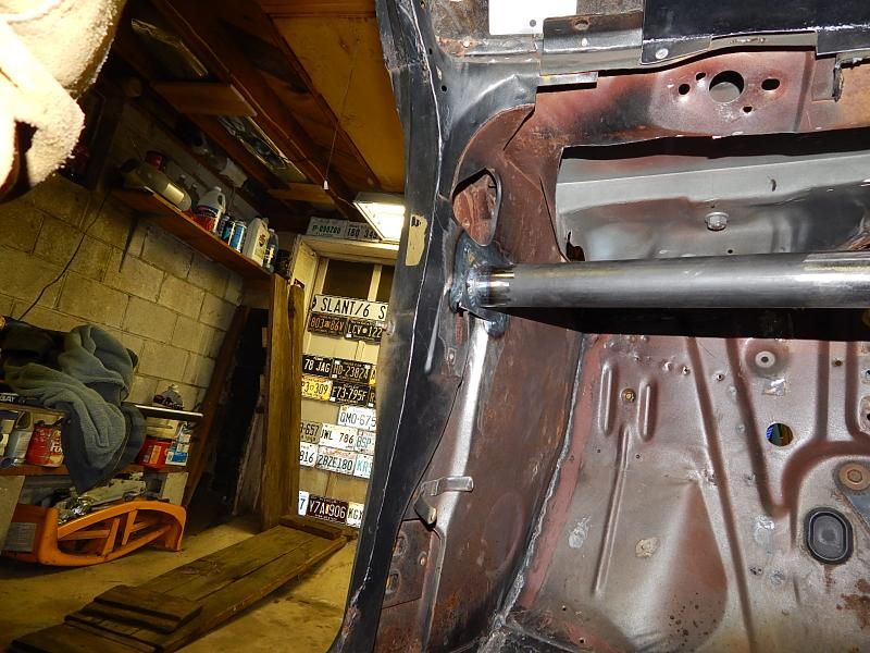

I also was able to Begin on the Dash Bar which is made from 1 5/8" X 0.53" 4130 Tubing. It, along with 2 small Shim Plates added 5.1#
Here are Some shots of the Bar Being Fitted.

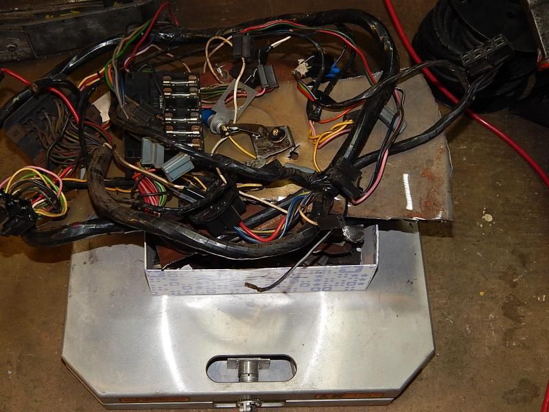

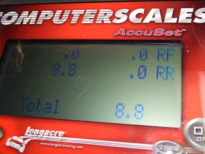

In Prepping for the Underdash Bar I was able to remove 8.6# of Underdash Stuff, metal, Wiring Harness etc. (take .2# off for the cardboard container)
So at last Check Ruster was 2082.3# -8.6+5.1..
That's a 3.5# weight Reduction.
Calculated weight should be:
2078.8#

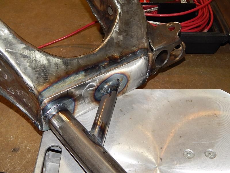

Some Shots of the Dash Bar All Tig Welded in place:
(you have to be a creative contortionist to weld tube in an enclosed car interior)
Next Some Fabbin on this Piece:
To connect it to the dash bar, Also a mount for the steering wheel, and getting the Down tubes bent and Welded in to connect the Front rails.

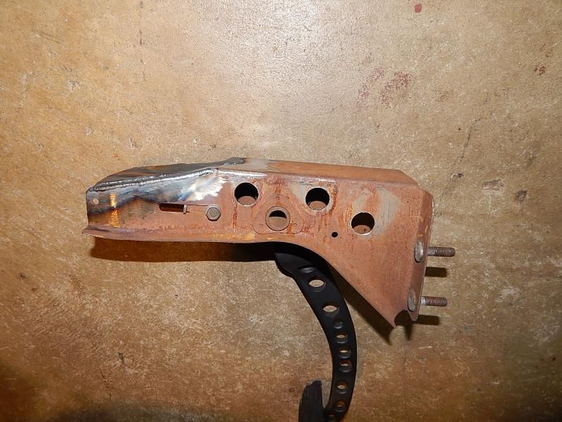

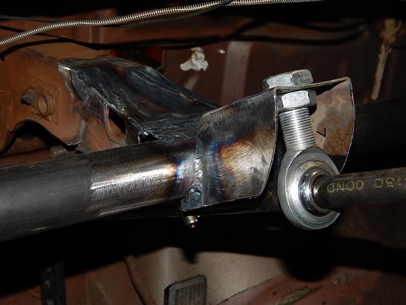

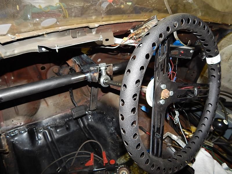

I got the Brake pedal mount Tied into the Dash Bar and a Mount for the Steering wheel all welded in and fabbed up.
I also Have Some of the New Oiling System Components Bought and Sorted out. They add weight at this point, but if they help to make more power that is good.
Here are the Pictures:

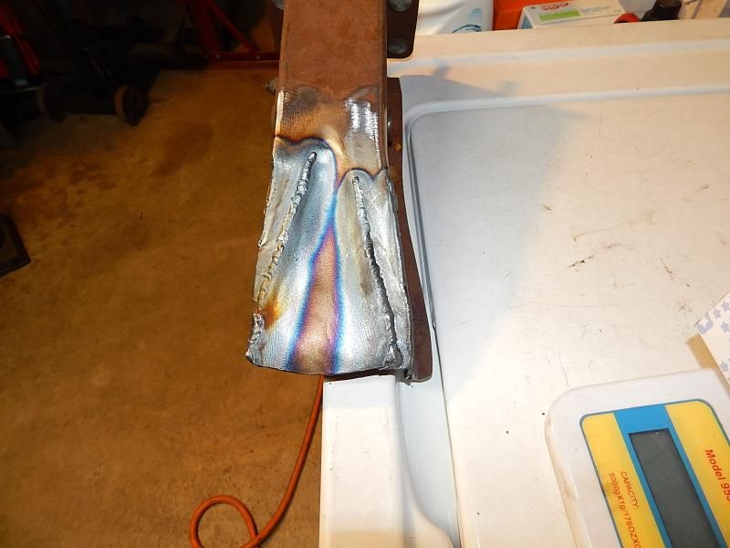

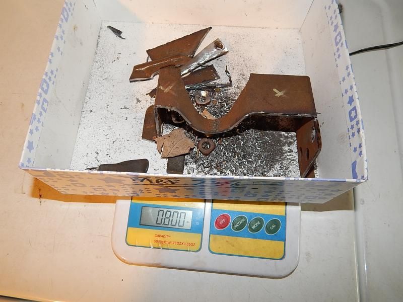

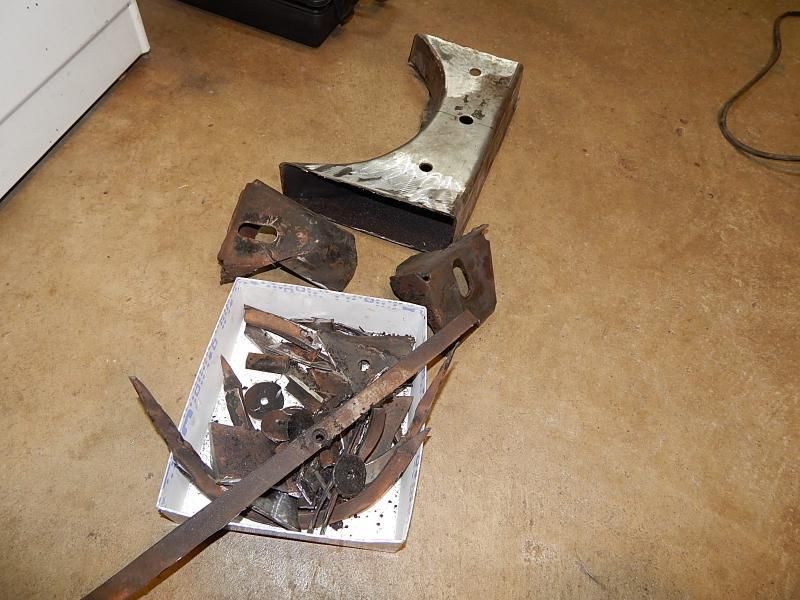

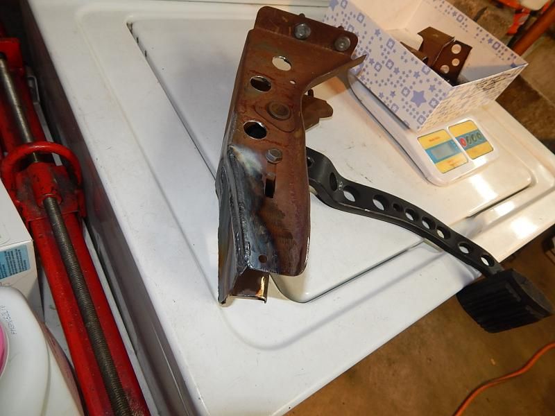

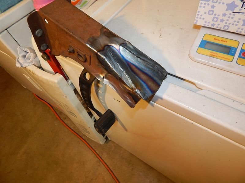

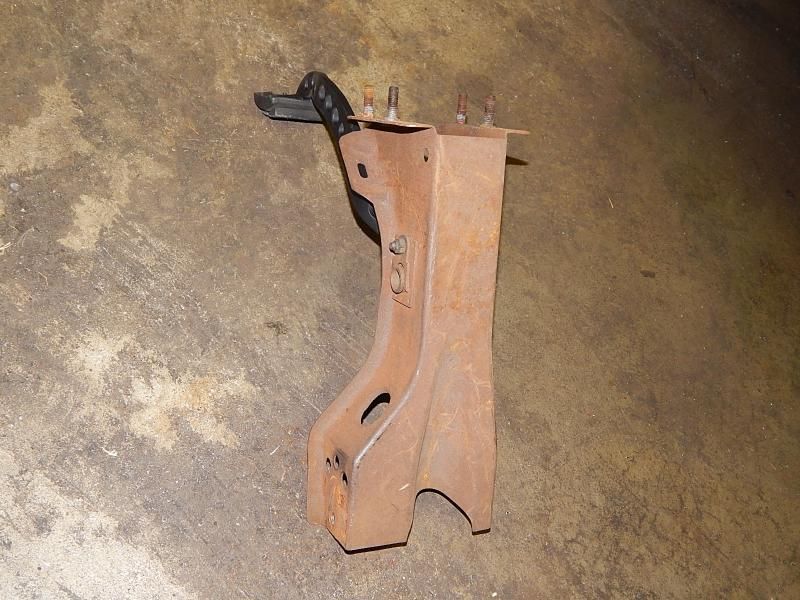

I did a bit of cutting and modification to the old factory brake pedal bracket; here are some of the parts I cut away.. The scale says 0.800#, but you must take away for the weight of the container, so that leaves us at 0.562#
Here ore some shots of that piece modified and tied together.
Here are some shots of it installed and welded to the Dash Bar, along with the steering wheel mount too.

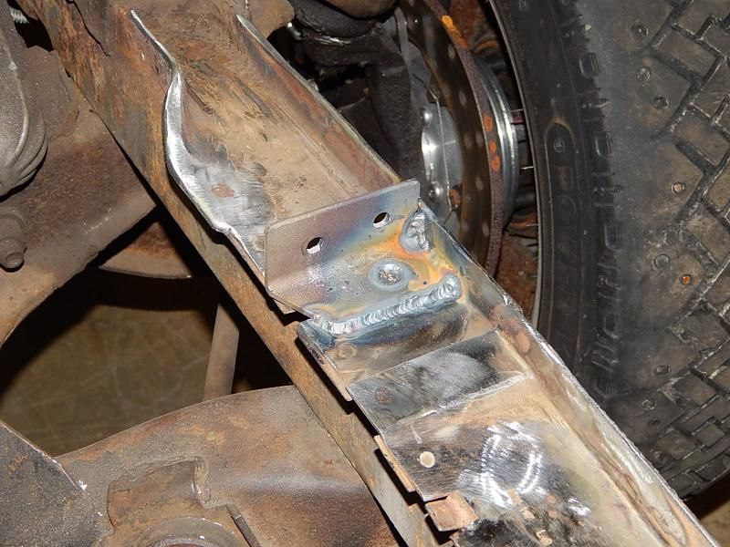

While I was welding a bit I did manage to Get the Mounting ears for the new Engine Plate installed..
This is Edd J's Engine Plate.. Excellent Design and It Fit into the A body Chassis without Much fuss.
The Engine Plate With all the Brackets and Hardware it was 5.620#
The stock steel mounts that they replaced were 6.5# YAY!

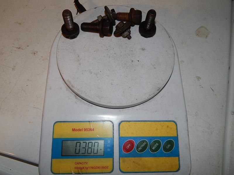

Here are a few more Bits that I will not be reusing.. -0.380#.

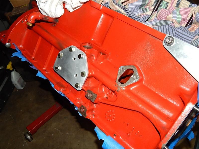

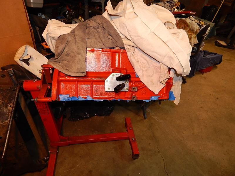

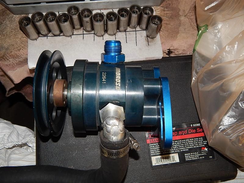

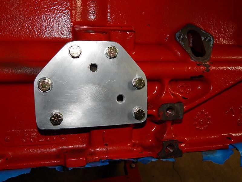

Here are some Shots of the Oil Pump Plate, the External Oil Pump, and the vacuum Pump, with their Weights.

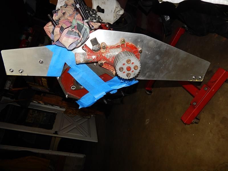

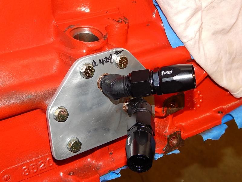

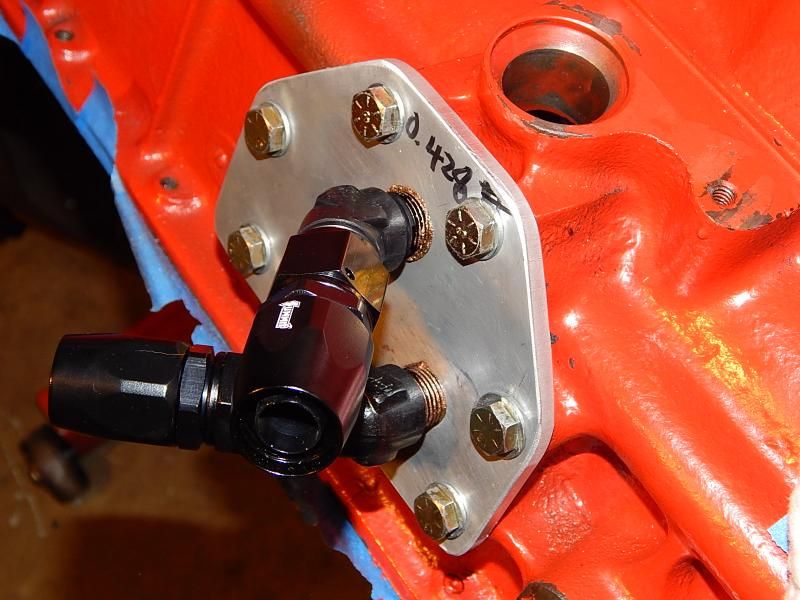

Here is the Oil Pump engine Adapter Plate that I had Made up:
It adds 0.428# to the car.

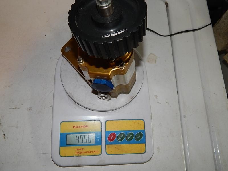

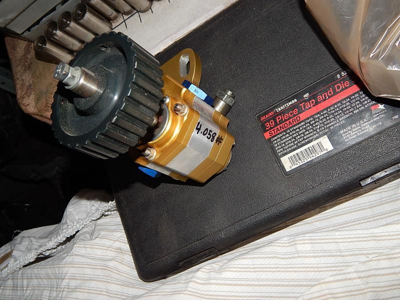

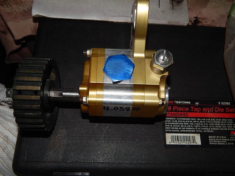

Here is the external Single stage Oil Pump.. It was an Ebay score and I believe the In and Out Ports are -10AN. It adds 4.058#

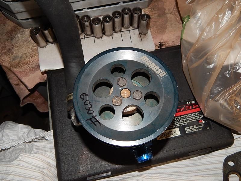

And finally THe Vacuum Pump.. It adds 6.030# Again another Ebay Score..

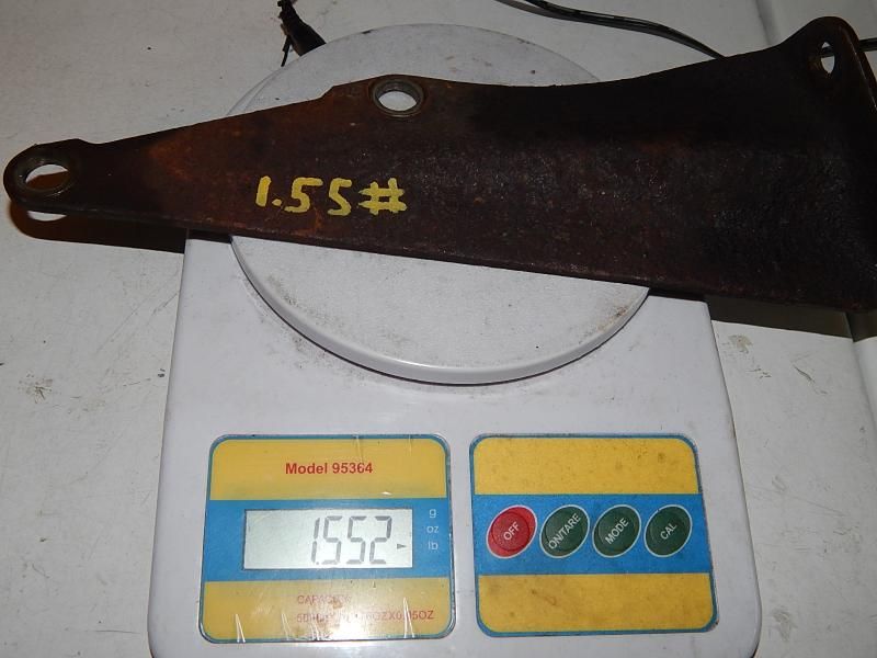

I am having a Local Fab Shop Make me one of these Transmission Supports from 3/16" ALuminum.. This one from Ma Mopar weighed 1.55# If I can Loose 1 # Here I would be Happy.

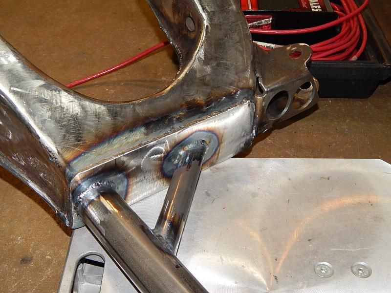

I am Having Some Downtubes made up to tie in the Front Frame rails to the Dash Bar.

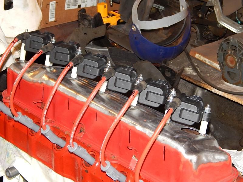

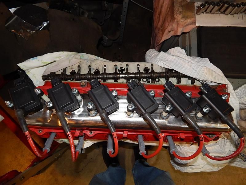

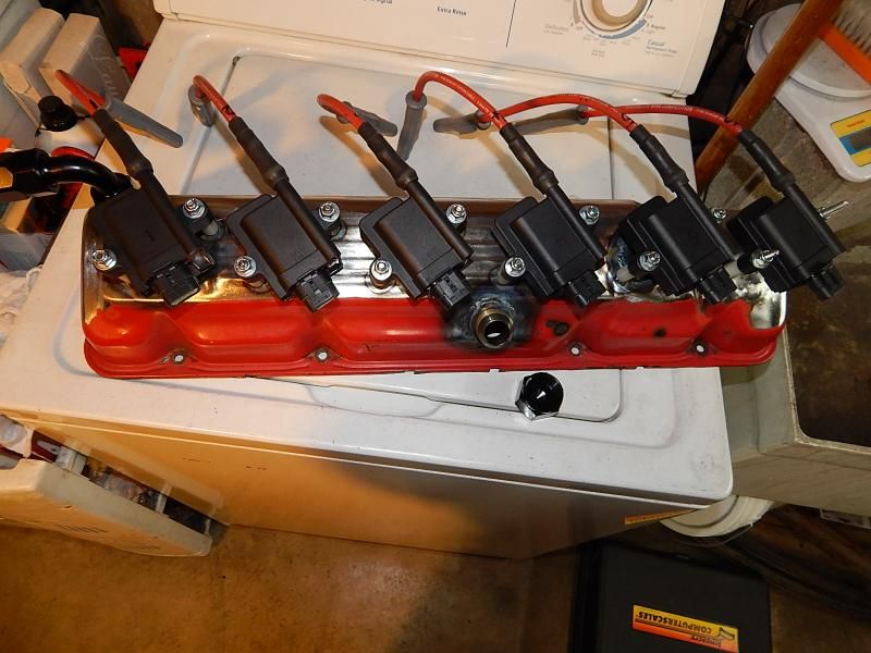

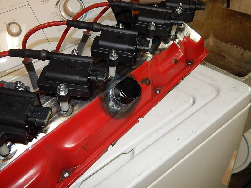

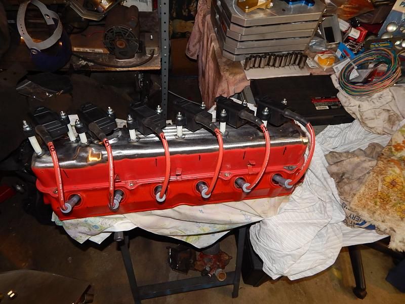

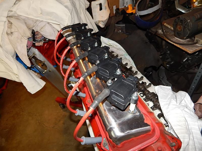

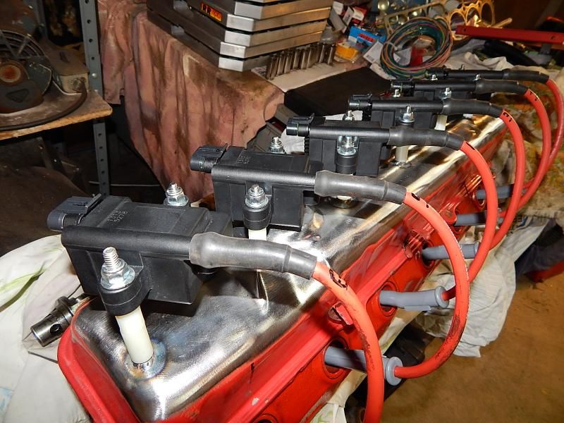

Since The oil pump gear on the cam was Pretty much Trash for all intents and Purposes I am tossing the Distributor.. Going with A megasquirt 3 to run Coil On Plug Wasted Spark.
Here are some Fun shots of the Valve cover with the Coils plumbed up!

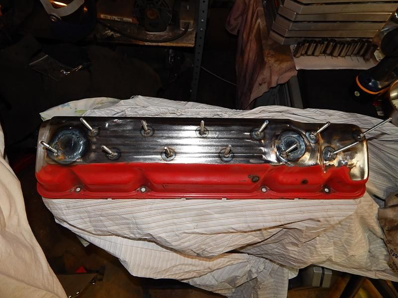

Now I just Need to relocate the oil Fill and vacuum Port. Also Weld up the Old Oil Fill (under #1 Coil) and Also Weld up the PVC Port (under #5 Coil)

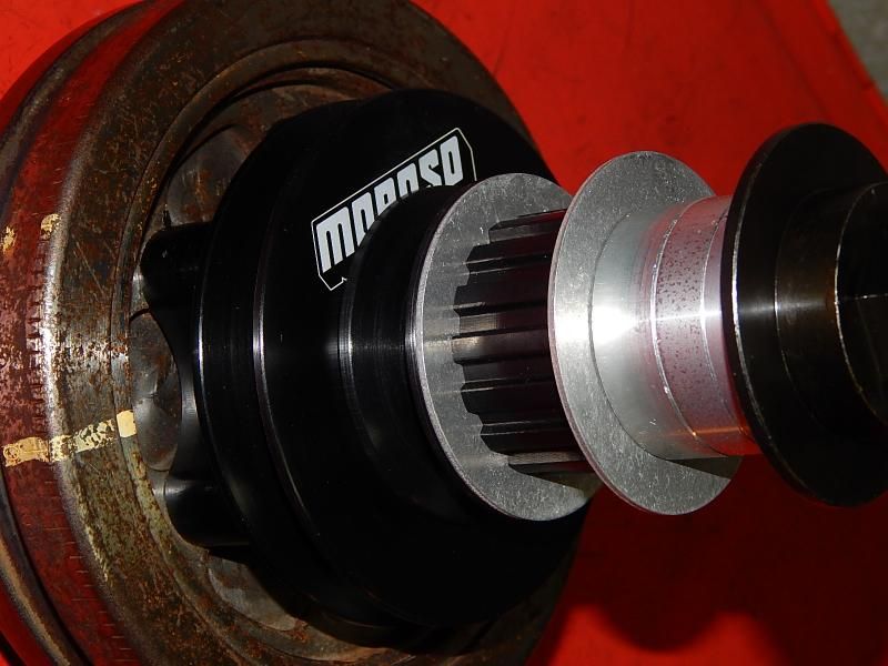

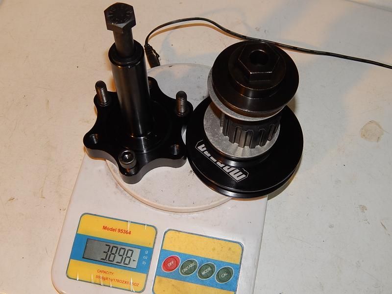

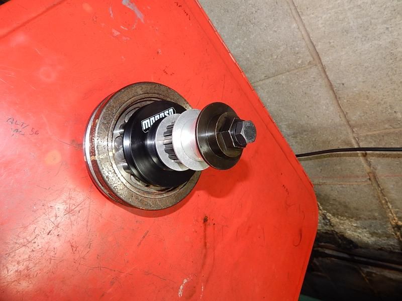

I was able to Find a mandrel Drive Kit that Bolts up to the Romac Slant 6 Balancer without much Fuss... Its A Moroso Dry sump/ Vacuum Drive kit listed for a Small Block Chevy.. 3 of the Bolt Holes Line up pretty well with the Romac.. i enlarged them from 25/64" to 27/64"

Rick.. To answer Your question yes those 6 coils did add weight.. But I have already taken Just as much off the K frame.

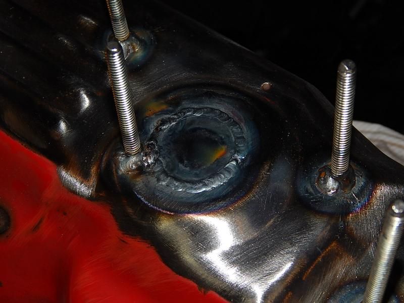

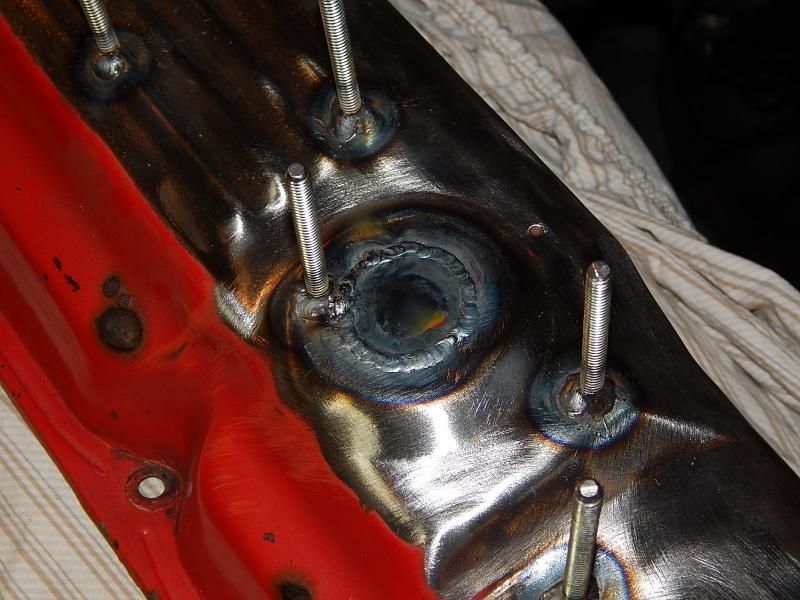

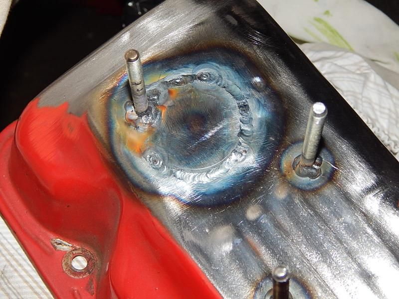

I made some circular Plates to weld over the old Oil Fill and the Old PCV port on the valve cover.. I Tig'ed them in place.

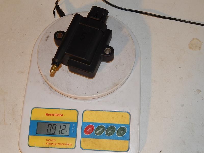

Each coil Weighed 0.912# X6= 5.4#
The Small Block Chevy Mandrel Drive Kit added 3.9#

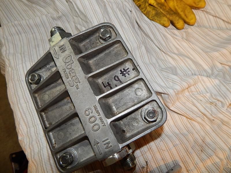

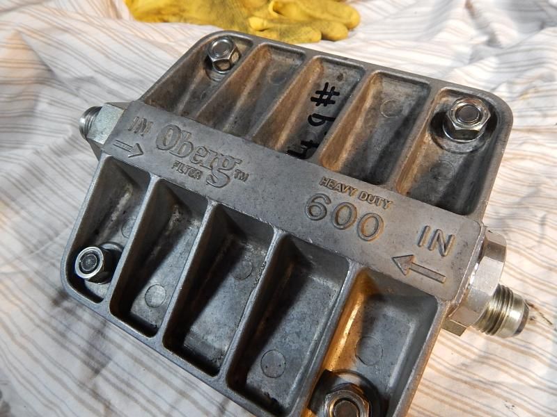

And The Oberg 6" Filter Added 4.9#

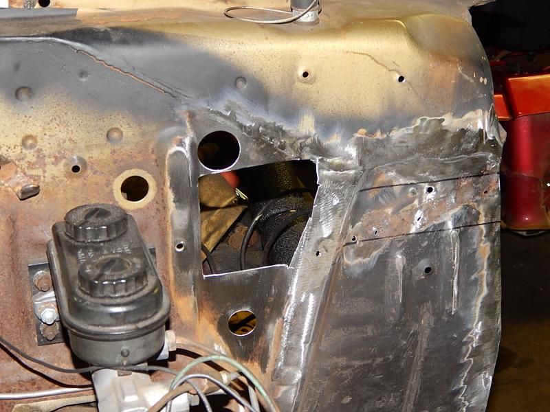

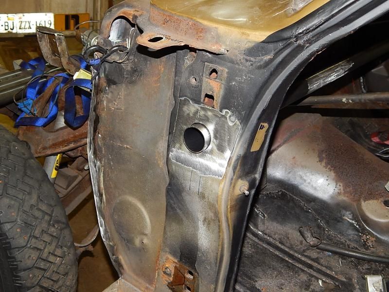

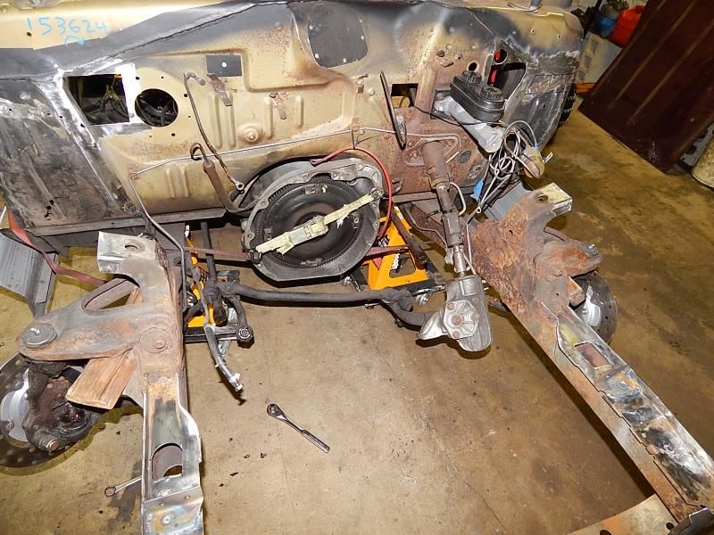

Here are some Shots of the Front end Getting ready for the Down Tube Install.

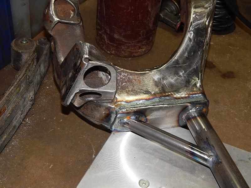

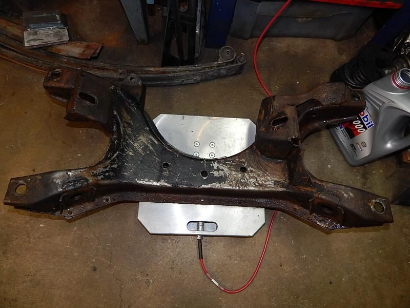

I have also Begun a K frame Diet Plan... This thing Will be sliced and diced a whole bunch before it's reinstalled.
It weighed 32.6 Before any Modification.

Add 3.9# for the Mandrel Drive.

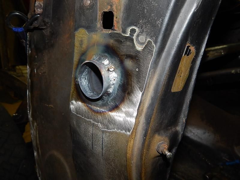

Here's What I got done today:

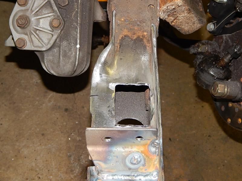

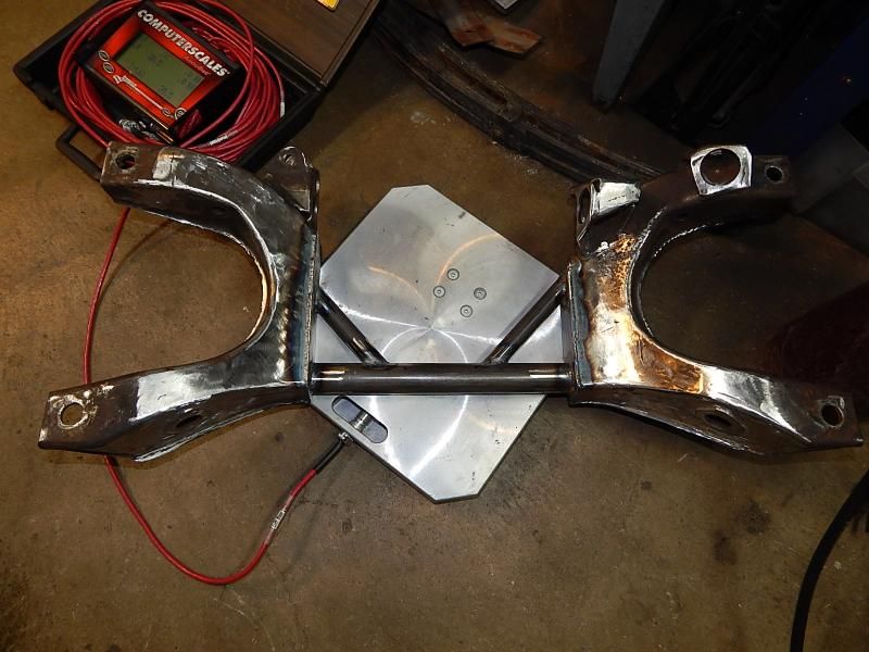

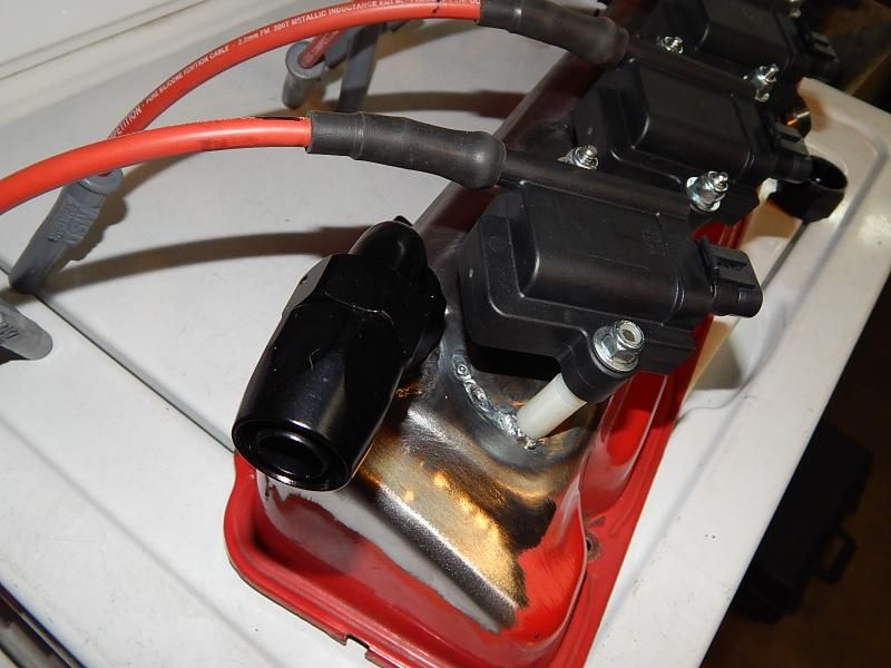

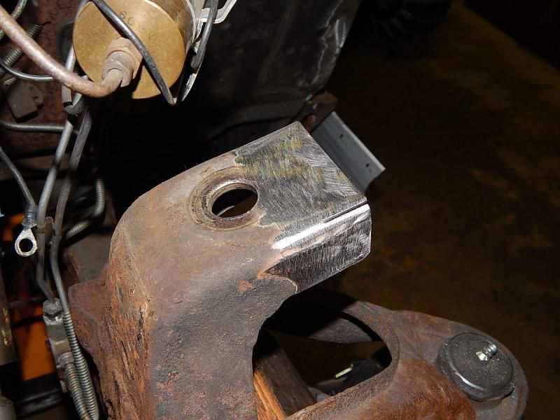

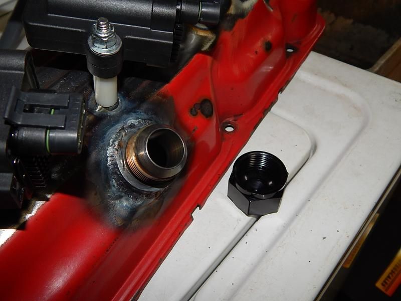

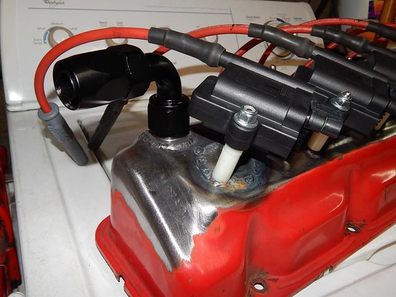

I finished the K frame and the Valve cover. The K frame is much Lighter and more Swiss cheese looking than before. The Valve cover got a -12 Bung for the Vacuum Pump To pull from and then I welded a -16 Bung for an oil fill and Cap.
Here are some Pics:

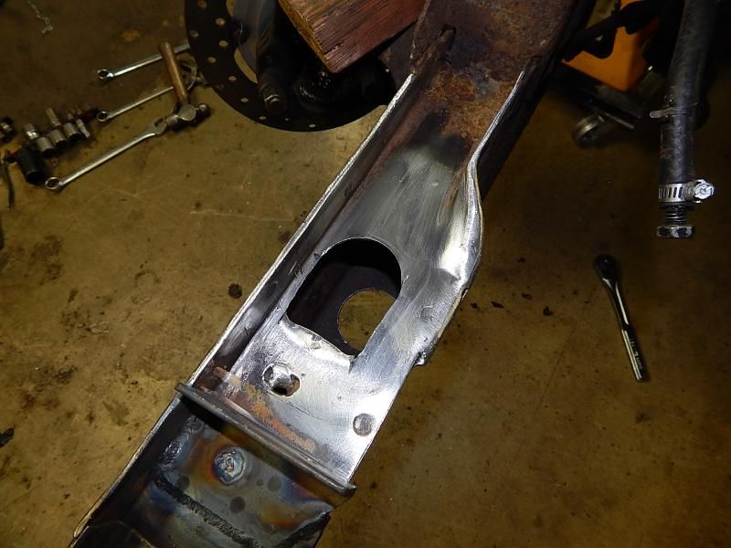

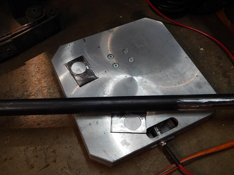

K Frame Before Cutting and Hacking:
K Frame after Cutting and Hacking:
Heres all the stuff that came off of it:

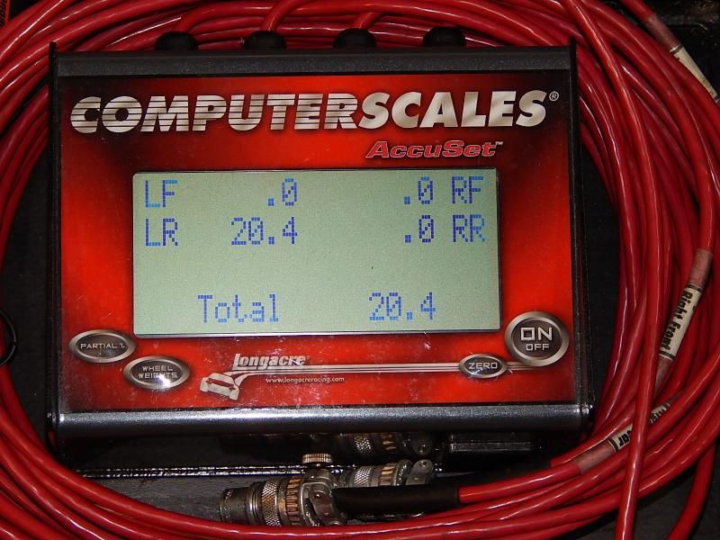

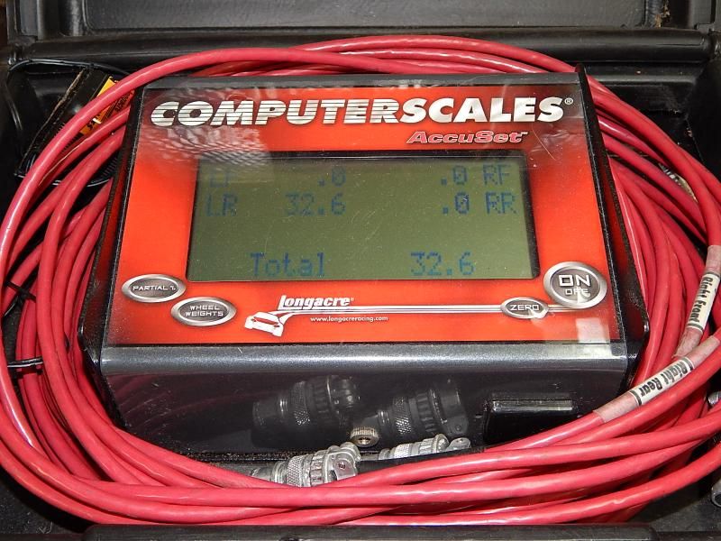

The Weigh In: Before it weighed 32.6
Now:
YAY 20.4# K frame..
Ruster Looses another 12.2# off the Front!
Calculated Weight is Now: 2090.4.. Back Below the 2100# mark.
Here are some shots of the Valve cover with Vacuum and Oil Fill attachments... before paint.
