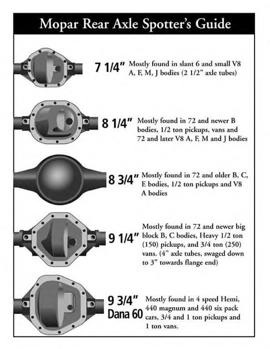

I recently got a rear end at the local picknpull and im trying to find out what it is. Anyways, its from a 79' dodge magnum. It has a 12 bolt cover and is fairly large. I am unsure of the gear ratio but it seems to be a somewhere around 3 and a quarter. There are 2 casting numbers on it. Also it is posi. Ignore the periods, they're just spacers the best i could do.

That would be the 9.25" axle.

How about this?
ImageMr. Rico

Sounds like it must be a 9 1/4, the magnum is a b-body so its real possible.

A 9 1/4? ill look more into it. That may be the case though because the axle tubes are tapered about midway. 10'' drums also

Look in to it more? Did you or did you not say it has 12 bolts holding on the cover? Look at the Mopar axle spotters guide I provided you with. The only Mopar rear with a 12 bolt cover is a 9 1/4. it also states that they can be found in b-body cars, you said it was out of a Magnum, a B-body car. Tapered about midway? It states 4" axle tubes, swaged down to 3", now what do you think it is?
Yes please look into it more. tell us what you see.

Rico- Haha ok maybe I chose the wrong words, it's finally ID'd now. The next thing is to get it shortened a bit to fit under the valiant. the 7 1/4 is 51'' from drum to drum, this one is 55. I could install it as is but then i would have to get flat tuner looking rims in the rear :? . so so~ thanks for the help.
