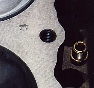

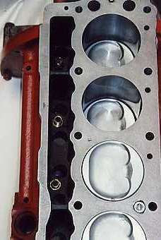

I took my head out today and found this.....
here are the ones from piston 2 and 3
I am pretty sure I am missing holes here
cil 4 and 5 no wonder cil number 4 has oil in it :cry:
:cry: :cry: :cry: :cry: :cry: :cry:
if you cant see the pics check the links
http://img2.uploadimages.net/141293blockoil.jpeg
http://img2.uploadimages.net/287403blockhole.jpeg
http://img2.uploadimages.net/233784blocknohole.jpeg

ummm did you take a look at the first pic where the oil was as high as it could go???(circled in red?) I don't think that's normal...
and yes I saw that article where he has 2 oil holes in 4 and 5 and mine has none ...nada
there is not even a hole like the others where oil could go back down....
when I took a lifter out then was it when the oil (allot!) drained back down
I find it weird that cil 1,2,3 ,6 has oil holes near the lifters as 4 and 5 don't
block has been resleeved and new rings ..less a year driving it

Even if you're missing drainback holes there, how is that going to put oil in the cylinder? That area is not pressurized, and the head gasket should keep the oil out of the cylinder. Even if it backs all the way up into the cylinder head, that's down on the pushrod side and it shouldn't cause oil to pool around the valve stems.
It may not be optimum to have that much oil pooling on the lifters, and cam oiling might be better with the standpipe modificaiton mentioned in the other post, but I don't think its causing oil in #4. That's some other problem.
