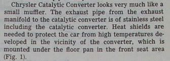

OH NO!! You sawed up and tossed the exhaust pipe from your 1975 Dart? Shame on you! Do you realize the 1975 cars are the only year A-body that came with a stainless steel exhaust pipe from the manifold to the muffler?????

Pretty sure Craig is kidding about the stainless headpipe; the factory parts books show no different P/N for the '75 vs. '76 headpipe and I've never seen a headpipe, even on a '75, that a magnet wouldn't stick to.
Nope, Craig is NOT kidding about the stainless head pipe. I still have the pipes from my 1975 Valiant. The pipes are perfect after all these years of Minnesota winter road salt. The hangers and the flange things (don't know the proper name) where the head pipe and cat pipe connect to each other are rotten because they are made out of plain old steel.
Here is scan from 1975 factory service manual.....
Remember, 400 series stainless steel IS magnetic and will get a brown rusty looking surface color to it and fool you to think it is not stainless steel. 300 series stainless steel is not magnetic and stays shiney unless it is in contact with other iron which will make a rust stain on it.
Now on my 1976 Valiant the head pipe is aluminized steel and rusted through where the hanger touches it by the rear transmission crossmember. I brazed that hole shut for now but in the future may need to install the stainless steel pipe from my 1975 Val.
