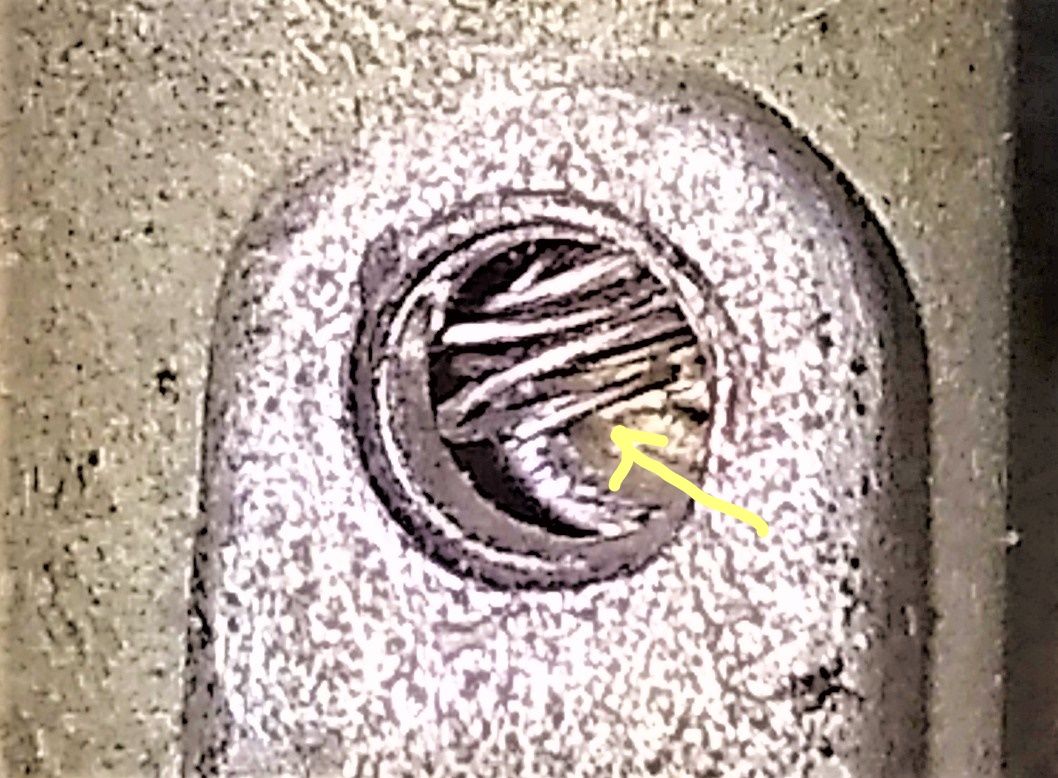

| Author: | matv91 [ Sat Sep 26, 2020 6:06 pm ] |
| Post subject: | Re: Removing power valve plug |
file plug flat, center punch use 1/8 or number 28 drill bit. Real easy do not go too deep. When done tap ball with small hammer. |
| Author: | matv91 [ Sat Sep 26, 2020 6:25 pm ] |
| Author: | matv91 [ Sat Sep 26, 2020 6:29 pm ] |
Left over drill remnants, if this happens bend paper clip like a fish hook, will come right out. |

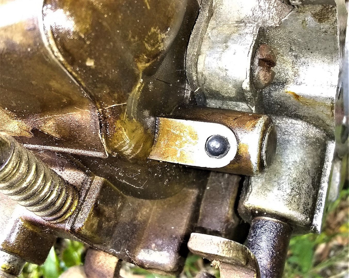

| Author: | matv91 [ Mon Nov 02, 2020 6:22 pm ] |
Here's that ball ready to be tapped with the hammer
| Author: | matv91 [ Mon Nov 02, 2020 6:25 pm ] |
After tapping with hammer epoxy can be applied to the outside, as a secondary measure against leaks |
