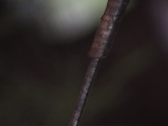

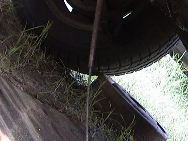

the other day I was driving home and the speedo just quits. I got home and unscrewed the cable at the speedo and pulled it out. It was fine and intact. I looked under the car and found the housing for the cable broken.

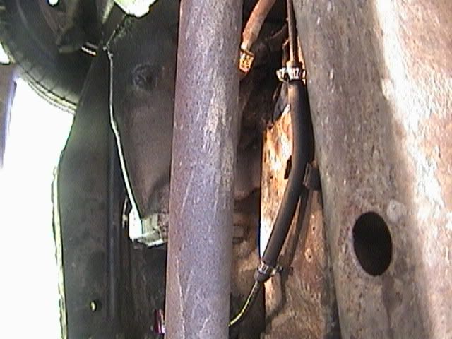

I slid some 1/4" fuel line over both pieces of housing untill they butted against each other and clamped it down with some hose clamps.
speedo is working just fine again :)
