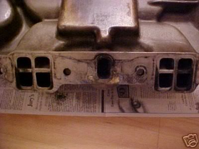

I have only recently learned about them, and i have only found them for Ford inline sixes, Volkswagen air-cooled motors, and v-8s. Here's a link: http://www.offyparts.com/product_info.p ... 53bd63a562
Here's a picture:
The theory is that the primaries on the carb feed the smaller tubes, and the secondaries feed the larger. Supposedly this give better fuel economy and low end torque. B.S.?

I can only make an educated guess, but with the smaller runners the air/fuel mixture will maintain higher velocity which should help to keep the fuel from separating out of the mixture. The increased stream velocity should also help to better fill the cylinders during the intake stroke.

i had a ford/mazda V6 once that had a similar style intake, only the large runners actually had vacum controlled butterfly style valves to close them at low RPM and open at high, this was an EFI engine but with the valves ziptied open there was a huge difference on the bottom end..

Now that I see it, it looks familiar. Someone made this type for the Jeep Inline 6 and from what I remeber the reason was better throttle response at low rpm because of higher velocity through those smaller primary runners. I guess the trade off is smaller total runner volume which will hurt at higher rpm on racing engines.

Not the same thing. Single versus dual port only referred to the opening on the cylinder head. On the single port, the intake ports were siamesed in the head, on dual ports they were siamesed on the intake runner. Single ports had better low-end velocity which resulted in better low-end torque, which especially suits them for a bus application, whereas the dual port has better high end velocity, which makes them ideal for a bug.

Those are Offy manifolds designed in the early '70s for the first gas shortage. Yes they worked, or at least the car magazine tests showed that they worked. I don't think one was ever developed for the \6.
Edelbrock at one time made a SP2P style manifold for the \6. Long out of production. Same idea, differant design.
