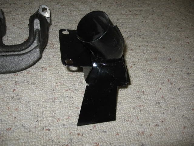

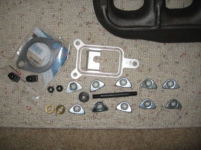

I just called NAPA and they cross referenced number and will get mine over night. They did not have cross for brass nuts but any will work I guess. I had to order in packs of 10. As far as the cone nut and triangle washers, I was pleasently suprised when I received my manifold from 1A Auto, they included a complete set of triangle washers, 2 cone nuts, 2 brass washers AND the correct heat stove. (I think thats what its called) brings heat up from exhaust pipe.

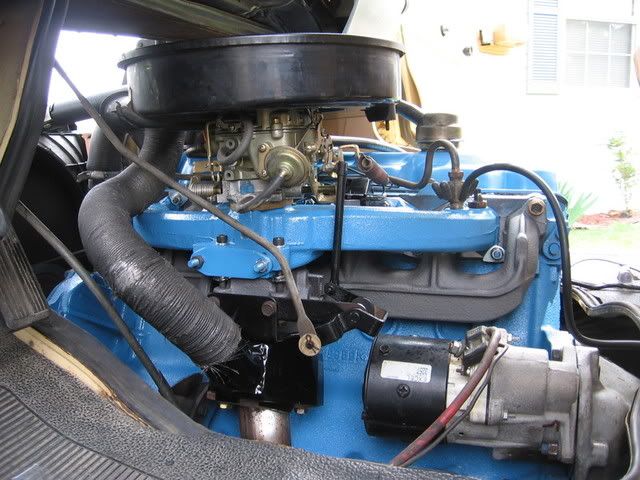

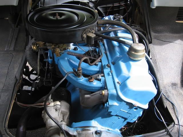

Here are pics. Also, I forgot to mention, they also included center stud and nut to attach manifold to manifold. I will have to pick up other two bolts but thats easy.
Jim

I think I need some final tuning. I didn't have time to do any since I got her running before work and had to get to a van run after work. It was a 2 1/2 hr drive and she ran like It never ran before. The free flowing exhaust makes a heck of a difference. I was cruising in OD at 75 and she hummed along.
Also, not sure if I mentioned but I used the POR15 Factory Manifold Gray on the new piece. It smoked for about 15 min, or it was the gasket, not too sure. But no peeling or flaking after the curing process. It looks real nice.
Now my question is, Is there anything specific I should change with carb or timing settings now that I have removed smog equipment?
I contacted the company that I pruchaced manifold from to see if there was any way they could put a kit together with the acorn nuts, brass washers, triangle washers, center bolt and nut, and heat stove. They are looking into it. Hopefully they can get it together and offer us a nice price.
What kind of interest is there for this?
