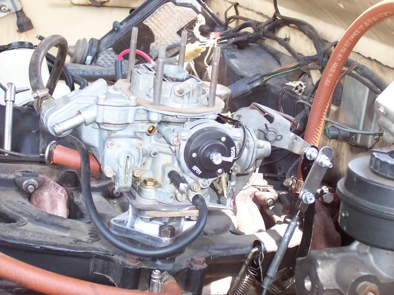

here's a pic for what it's worth
http://server13.ipslink.com/~mymoparc/f ... ost&id=129

PostPosted: Fri Feb 09, 2007 10:13 pm
Joined: Tue Aug 17, 2004 4:53 pm
Posts: 194
Location: Kansas
I have an 82 Miser. It appers that the RED is on the LEFT and the GREEN is on the RIGHT. You can just see it in this pic.
82 D150 Slant6 Shorty
http://www.cardomain.com/ride/658846
