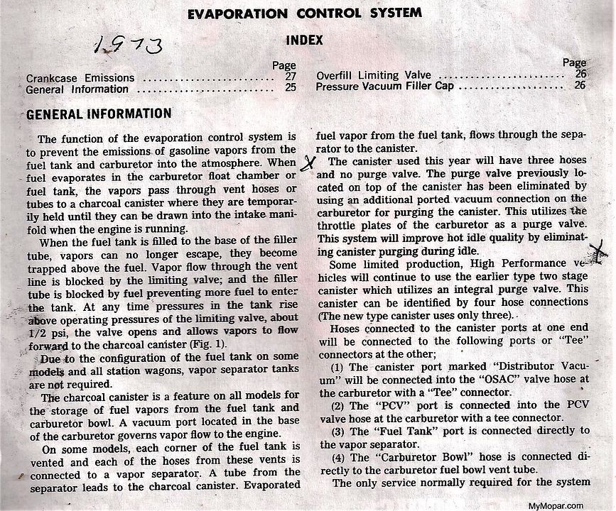

Author:  matv91 [ Thu Jun 16, 2022 7:33 pm ]
Post subject:  Re: Carter BBD questions
Author:  matv91 [ Thu Jun 16, 2022 7:46 pm ]
For 1973 should be simple, one line to tank vent, one to carb bowl vent not used cap it off and canister purge line, which goes to purge port on carb. On bbd purge port is right between idle mixture screws

Author:  SlantSixDan [ Tue Jun 21, 2022 4:18 am ]
That's for an exhaust air injection aspirator system your car doesn't have. Securely cap it off.
