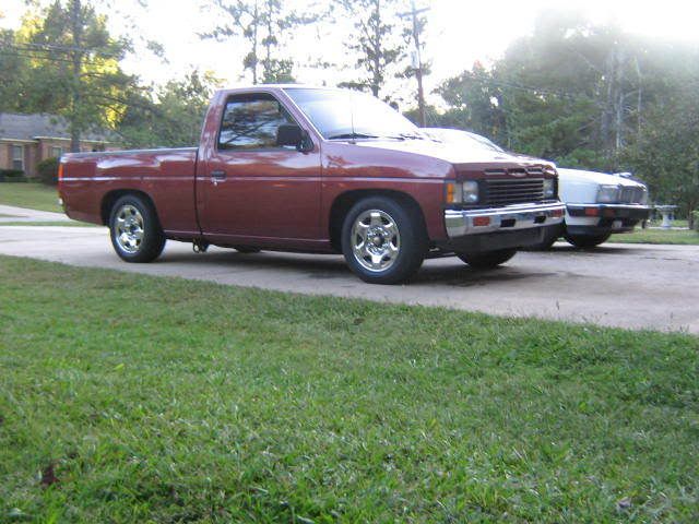

Maybe it will get here Sat'. In the mean time I'll runImage
this.
