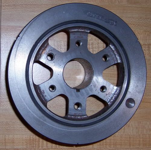

Happen to have an NOS balancer, and I never really looked at it closely until now. The part number on the box is 4095527, and the number stamped on the balancer is 85985 2283. With the keyway at 6 o'clock there is a timing mark at 2, 6, and 10 o'clock. The only mark that goes completely across the v-belt groove is at 6 o'clock, in line with the keyway. Wassup? Is this a generic one size fits all replacement or what? Have pics and would gladly post them but I haven't figured out how to do that yet. Hope this helps. :oops: :oops:

Hope this works.

It looks like the timing mark is in align with the crank key, since you said the 6:00 position is the only one going across both sides of the pulley.
I appreciate you posting the picture.
That really helps, thank you very much!
It is one of those details that I hadn't thought about much and took for granted too!

That pic is at an angle so its a bit hard to judge...
Please remember this offset is dependent on which timing cover (different timing mark tab location) is being used.
When DamperDudes built mine they built in a 5deg offset as they said that is what is right for me (1971 cover, 3 spoke dampner). I'm with Jess on this one, find true TDC and see. Once my piston stop comes I'll find out.
