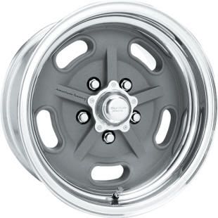

Edit: Came across these in 17x7" flavor while browsing Summit. Me REALLY likey. Thinkin they'd look awesome with a black paint job for the car.
Anyone think 4" backspacing would be sufficient for a Duster's wheel wells?
American Racing "Salt Flat Special"! That's two of us who likey ... although I prefer the painted centers.
Same here. I'd actually prefer a dark, almost blood red painted center on those, as long as I could do the same with the center caps. I don't know if the "American Racing" is just laser etched or is actually hard etched into the center caps though, because I'd want to put my design on those if I could customize the wheels.
for the price of the wheels, you can bet I'd do something different to them just so I'd be the only one with that perticular design...

Ya know, those Slat Flat's were my first choice until I saw the reissued Ansen Slot style. At least we wont all be doing the same thing.
