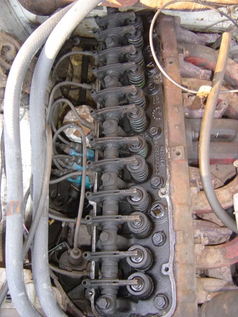

The odometer reads 88k... The first time I pulled off the valve cover nothing looked unusual that I could see. I'll try to post a picture here. Hopefully you can see it.

what kind of oil pressure are you getting. rockers look kinda dry to me

Too dry!
Should be wet everywhere. My 2.2 rockers/cam etc is WET with oil.
Look at rocker bar rear bolt that has narrow neck for oil feed is clear. There get plugged up.
Once you get that feed fixed, then look at all rockers that all are leaking of oil, it is supposed to drool oil to keep everything wet with oil.

Not sure how to check oil pressure... I'll take a look at the back bolt to see if it's blocked up w/ anything. It sounds like maybe I should pour some oil over the rockers before I try to start it?
Ideally with an oil pressure gauge. They aren't hard to install.
Here's some discussion.
http://www.slantsix.org/forum/viewtopic ... ht=#116737
You can check by watching the valves while the engine runs. Oil should come out throught the rockers, and splash around a bit due to the rocker motion. That should continue as long as the engine runs. Have some old towels or shop rags around.
I would. And down to the lifters.
