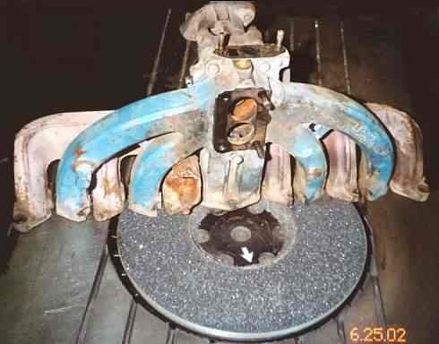

Have you read the article on manifold installation?
http://www.slantsix.org/articles/manifo ... unting.htm
The key to success is resurfacing and careful manifold alignment.
I use a Petersen "model 50" resurfacer to get all the surfaces clean and flat. I am in the South Bay Area so I could get your manifolds resurfaced if needed.

$40.00 to resurface a set of manifolds that are ready to go.
A little extra if I have to change gaskets, remove broken bolts, etc.

OK, I'm a little confused about the sequence to all this work. Do you surface the two manifolds first, then mount them to the head and then tighten the bolts? Or would you mock it up it get a good seal on the intake to exhaust, then resurface them bolted together and finally reassemble the whole thing?

From what i can tell and i'm no expert, you resurface them together as one unit and then back off on the three bolts at the hot box till it's loose but not falling apart, mount the whole assy to the head, once the nuts are all torqued properly to the head, you tighten the three bolts holding the hot box together.
Doug, is that right??
