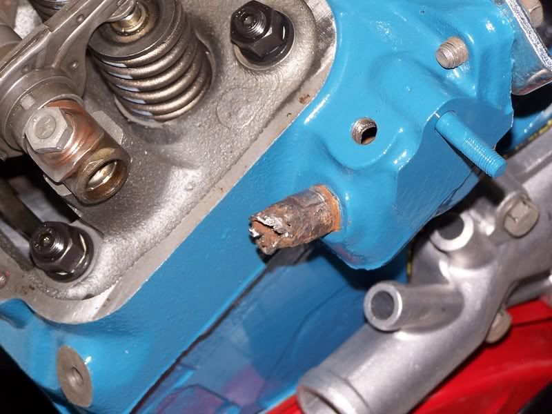

THere is a metal nipple coming from the cylinder head that is pretty corroded, but I could not get it out. here is a picture:
Will this cause me problems? My gut says, in the future it will continue to corrode and will eventually lead to a failure of the cooling system. what is this and what can I do to remove/replace/repair?

I had the same problem. I cut it shorter with a hacksaw and then cut a slot to put a big screw driver in it. Spray some Kriol and add some heat from a fine tipped torch. Put a crescent wrench on the screw driver and carefully twist it out.
Now to keep this happening again, you can get a stainless steel nipple or a brass one from the nearest boat shop or good hardware store. Don't buy the same kind (steel with cheap plating) from the auto parts store.
Nice looking job so far, just put a nice heater hose fitting back in its place.

Rusted water nipples can be difficult. I would fist try soaking it for a few hours with penetrating oil, such as Master Blaster. After a good soak, I would heat the head around the base of the fitting , then try to remove it with a good vise grip or equivalent pliers. There's a good chance it will twistoff and you might have to use an easy out or even carefully chisel it out. A thread chaser may also be needed. I hate to remove rusted fittings.
