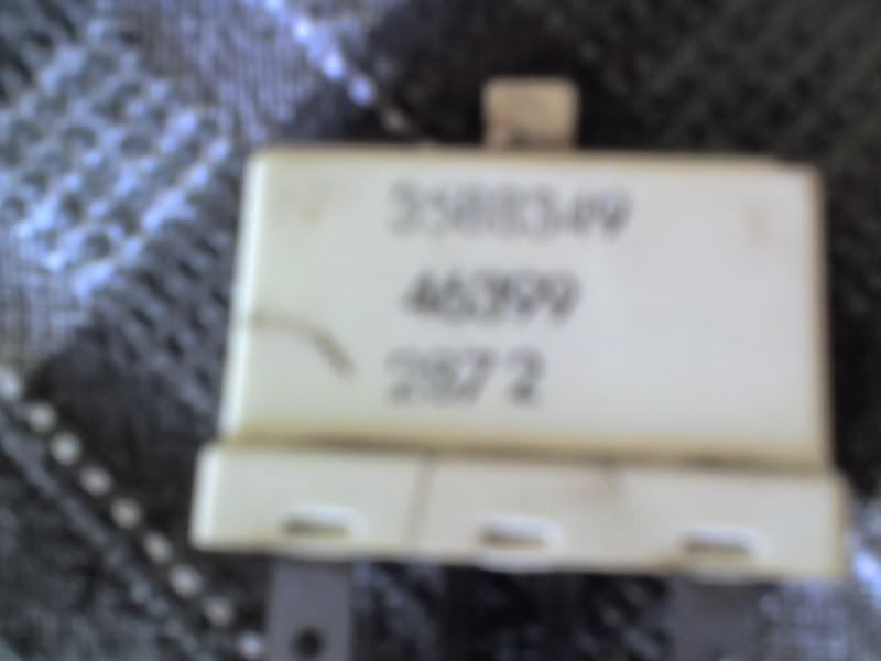

its white plastic with 2 terminals
3588349
46399
2872
on it
PostPosted: Tue Oct 30, 2007 5:01 pm
Posts: 24950
Doesn't show up in the '73 or '74 FPC numerical indices. Where'd you find it? Could be a warning buzzer or a delay unit. Pop the plastic cover off the base and take us some good clear/sharp pics of what's inside.

i'll have to borrow a decent digital camera, all i have is a cellphone camera. i found it when i was pulling the dash, and i am looking for anything i can replace at this point.

That looks just like the buzzer in my 74 Scamp. It's great for reminding you in the most obnoxious manner possible to remove the key from the ignition.

Sure looks like the seat belt buzzer in Aaron's '74 Dart Sport. The little nub on the plastic housing fits in a hole and locks into place when you twist it in a metal bracket held in place by a screw immediately under the emergency brake handle.
Or not... :wink:
