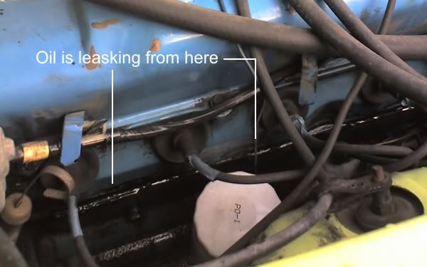

very slow oil leak please see image 225sl6 1973 dart
what do i need to do to fix this?
and yes leaking is spelled wrong on the image
PostPosted: Sat Nov 03, 2007 4:04 pm
Posts: 24799
First, make sure that's actually where the leak is coming from. See this post.

Dan's right, but it is really hard to say where the leak is until you clean up the mess and watch for it. I started a thread in the last year about oil sweating out at the same place (or rather at the head to block joint on mine)
After trying retorque and both rubber and cork valve cover gaskets, it was time to pull the head. The culprit? one of the evil VICTOR gaskets...I shoulda used a FELPRO on my rebuild. Curses on the Victor. But it was enough work to pull and replace the head that I put a thin line of high temp RTV ont the block around the lifter/pushrod holes before putting on the new Felpro, and used an ARP head stud kit. Nary a leak since... oh, of course new gaskets on the drool tubes and cleaning them well with lacquer thinner and acetone to be sure the gaskets had a clean fit. If you need a set of gaskets for the tubes lemme know, I will send you a new set free for postage. Puttting them on is a good first step but don't buy a set just to get em.

well i have been looking at it this morning and it looks like the head gasket. plugs and valve cover gasket is dry.
nooooooooooo!!!!!
