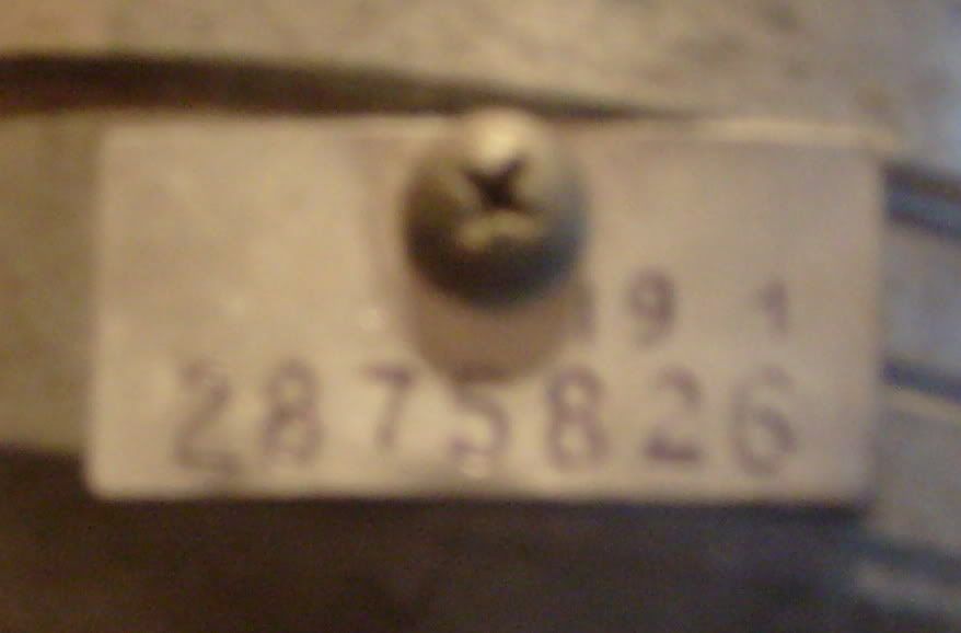

I am hoping that someone here can identify these 2 distributors for me.
Both vacuum cans are marked 6.5X on the arm.
Any help would be greatly appreciated.
Thanks in advance

2875 826 = 1970 198 engine with automatic transmission, without California emissions.

Thank you Dan.
Wow 2 198 distributors and neither came to me in a 198. Who would have thought.
