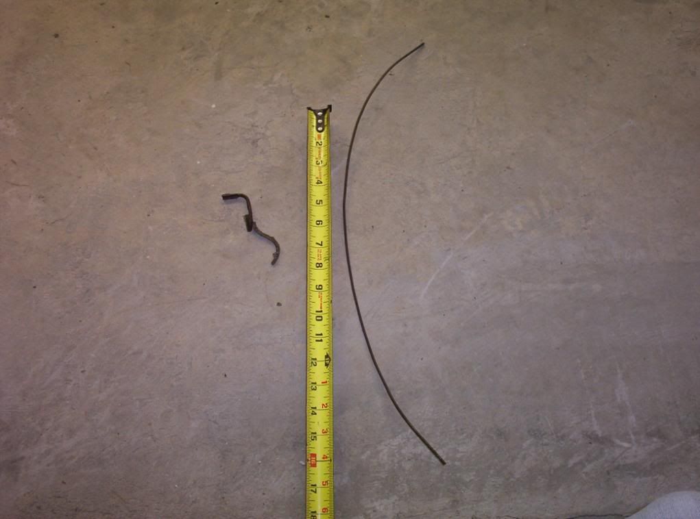

This is what I found when changing the thermostat in my 64. The thermostat was dated 2-64 and looked to be original. I was shocked that debris like that could have been in the water jacket in the thermostat area without causing problems. SSD said finding items like these is a common occurrence.

I pulled 5 or 6 wires like that out of my head. They were used to secure the sand cores during the casting process. After casting the sand was shaken and perhaps flushed out but the wires were left behind. Those are prefectly normal and not at all extraordinary.
