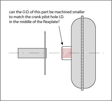

can this be done?

Posts: 24763
No, that is not an option.

Posts: 14724
Yep. The snout is usually hollow and machining it will cause it to break through.
