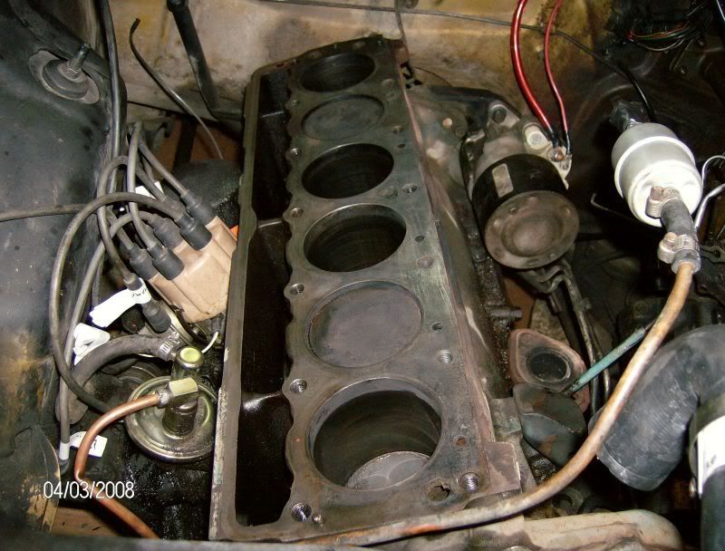

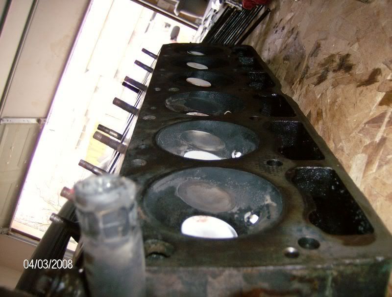

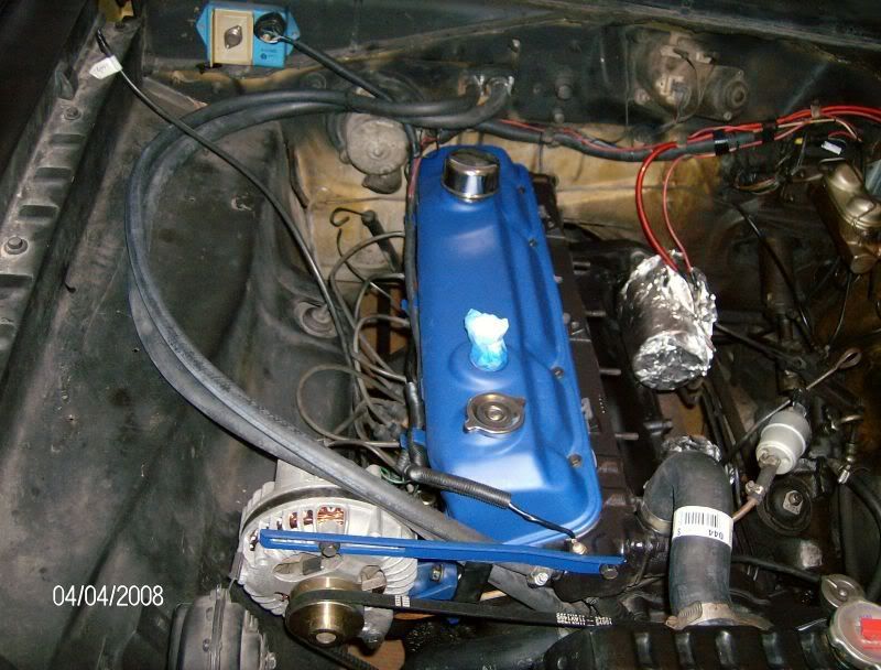

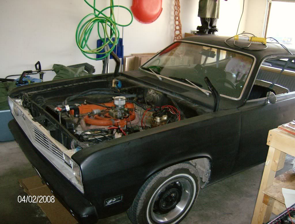

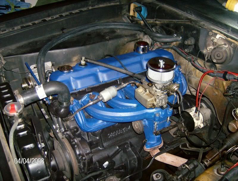

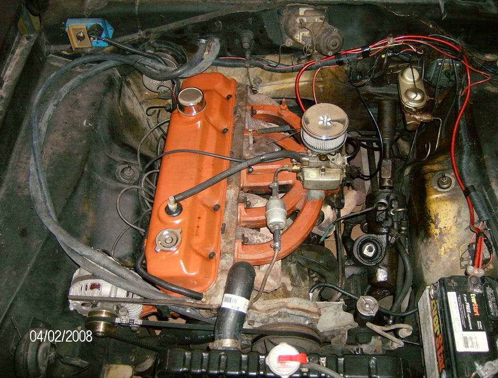

Hello, my name is Arthur and I have been watching this board for some time now. I can say that you have all been a real big help. even though I have never asked a question. lol. Let me tell you a little about my self. I am a Iraq war veteran that has been medically discharged from the military in Dec/06. I have 4 children and a wonderful wife that "lets me stay home with the kids" so I guess I'm a S.A.H.D. :shock: The Stay at home Dad.
In Jan 08 I bought a 1971 Plymouth Duster with a slant 6. When I bought the car it wouldn't even start. I paid 2K for it. I thought that since the body was in real good condition and the engine was not frozen that was a good price. I towed it home and to my surprise all it needed was some T.L.C. and a battery and she fired right up after some tuning she was able to stay running. :D
Now that she was running I soon found out why this guy wanted to sell me the car......Blown head gasket. Guess he did not want to hassle with it.
Oil was every were. no problem. I figured I could handle the situation. so I looked online for some advice and found www.slantsix.org You guys and gals have a very wide range of information. Thank you so much.
For the most part I was able to rebuild the head and up by just searching for my problems. I figured that you didn't want any repeat questions. As I know that could start to get old.
I did buy the books that have been advertised so much on this site. Thanks Dan for the advice. :) Stockel auto mechanics fundamentals, the Perterson automotive troubleshooting and repair manual, and the shop manual. man the shop manual set me back 90 bucks. These three books have been a tremendous help.
Here are some pictures of the car and the rebuild.

Arthur,
Well done! That's the way to do it.
A little research and some time and your back in business.
What are your plans for the car?
Did you mill the head while it was off?

Well i bought the car for my daily driver. I sold my last car to get my wife a blazer. :cry: But she let me buy the duster so i can't be mad at her. :)
As far as the head. No I did not get it milled. several reasons for that one is that I figured that if it keeps leaking then it would only set me back the price of the gaskets and the milling. Plus I was not to sure about the milling process and what all is needed to do that. do to buy any thing else? as far as parts will every thing still fit the same? as far as parts. I am no mechanic but I am learning little at a time. I was really not that confident in myself until after I put this engine back together again and it did not explode. :lol:
The other reason is if I have to do allot of work on it then I would either buy another 225 and rebuild it while this one is still it it and do a swap later. Or just pull this 225 and do a complete rebuild on this one.
So far the gaskets are sealing great no leaks. around the head and the block. I was scared for a while when she was blowing white smoke :shock: Antifreeze!!! But it soon stopped. I called my father and he said it was probably just burning off some of the old junk left inside.

If it runs ok and doesn't blow another head gasket, then you may be fine without milling.
But there is also the possibility that the head surface is not flat... which can cause the head gasket to blow.
Milling is not a big deal. You can go as much as .100" if you want to raise the compression that much, but probably a little less is better for you.
For now, keep it the way you've got it, and start thinking about the other things it might need (for instance, do you have drum brakes on the front?).
