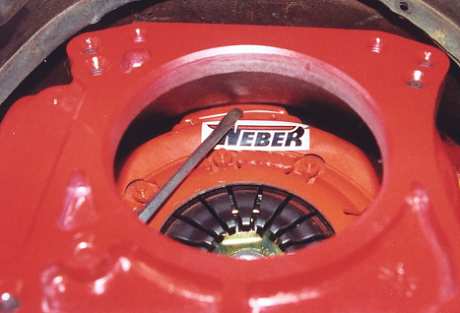

I would use the factory "Borg & Beck" 10 inch HD SL6 pressure plate listed for Vans, Taxi & Trucks. This unit will bolt right in and can be ordered with lot's of spring pressure. (shoot for 2400-2600 psi)
We used the Weber 10 inch for the Hot Rot Mag build-up. (I think Weber is now part of McLeod)
This is a F@%d 10 inch unit and it gave us some interferance problems, we fixed it with a grinder.
The unit works well and has taken a lot of abuse.
Here is a PIC and a link.
Weber Pressure Plate Install

I bought those very parts from Steve at Hot Rod a few months. The fly wheel, clutch, pressure plate and bell housing in that picture. I can't wait to get it all together.
