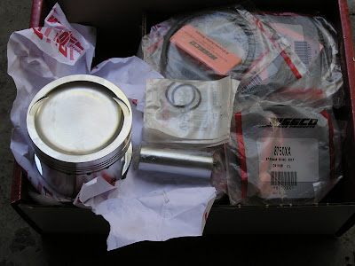

You can see the Wisco pistons here, and the thin rings. They look like good quality. This is a 2.2 turbo design.

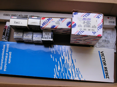

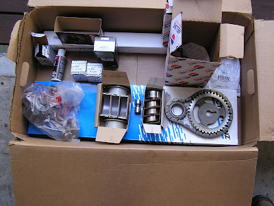

All name brand parts here. You could do worse. This box was shipped separately from the pistons, and made it to my house just fine in April.

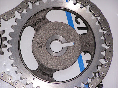

Hmm, what's up with that timing set?
I don't think the designers of this were thinking about degreeing in a cam.

Thats not an OEM quality cam gear for an early slant....
I got one of those when I ordered a stock timing setup for the BV, back a few years... that is now what you get... you want something better... time to order a roller chain, or order the Dynagear set (where the gear can be degreed, but the metal for the gear is a bit more potmetal than I like...)

I have to ask what is wrong with metric rings ? Being thin has nothing to do with being for a turbo or not as far as I know. It is the thin metric rings that are proving to be some of the best out there.
The pistons from what I can see are of good design also, its hard to tell much from a single angle pic but it looks like the skirts are a good setup and the pin boss width looks nice ( good strong design) . A set of custom Weisco's with pins and good rings are not cheap, maybe even 2/3 of what you have give for a kit.
Cant say much for the cam gear, pretty cheap but I do think its either this or a roller setup, but its only one small part that can be replaced.

On the rings I see there is package numbers, these could be run to see exactly what rings you have. The thin metric rings are prefered, if they are of the right type to fit your need would be the question. But I can promise you that the thin metric rings will be more durable, seal better, and give more power than the old standard ring your use to. Like I said, what there made of, and style would be the question to ask to find out if they are good for a turbo app.
Just something to look at, take a ring and see how good it fits the ring land of the piston, then compair it to what you have run in the past. I think you will find a pleasent surprize.
When it comes time to gap the rings, set the top ring to manufacture specs (for a boosted app), but set the second ring gap bigger than the top, trust me, it will pay off with power and better oil control and ring seal. Also be sure your machinist knows what rings and type your running, the hone has a big effect on the outcome.
The CC's of your dish may be a good thing, depending on where it really puts your comp. Many people really go to low on compression for a turbo setup, a street car can really make good use of a little more comp than a race car. It would not bother me to run as much as 9.5 to 1 if the turbo is sized right for the engine. Anymore 10.5 is used alot, even though it may scare the crap out of most people to even think about it. I am not saying to run either of these comp levels, but its being done every day. And like you said, its not a deal breaker and can be set to your liking when the time comes, which by the way you have enough meat to set it any where you like (better to have to much , than not enough) , you can make it less, but hard to make it more. Also, if lower comp is wanted than what you end up with, it may be the chamber shape you wish to work on instead of the piston bowl.

Back to the pistons. I did some research on this last night, and Lucky is right that I shouldn't be so dismissive of metric rings. The SRT-4 Neon motor is using rings just like this, as is the Evo and other turbo cars. It seems that as long as you have strong piston lands ( the part that supports the rings), thin metric rings will work.
These are Wisco pistons, and considering the other thread about rod/piston combinations, this may be a bit of a preview of what would be offered in that combo. Would it be helpful to take a couple more pictures of these pistons?
