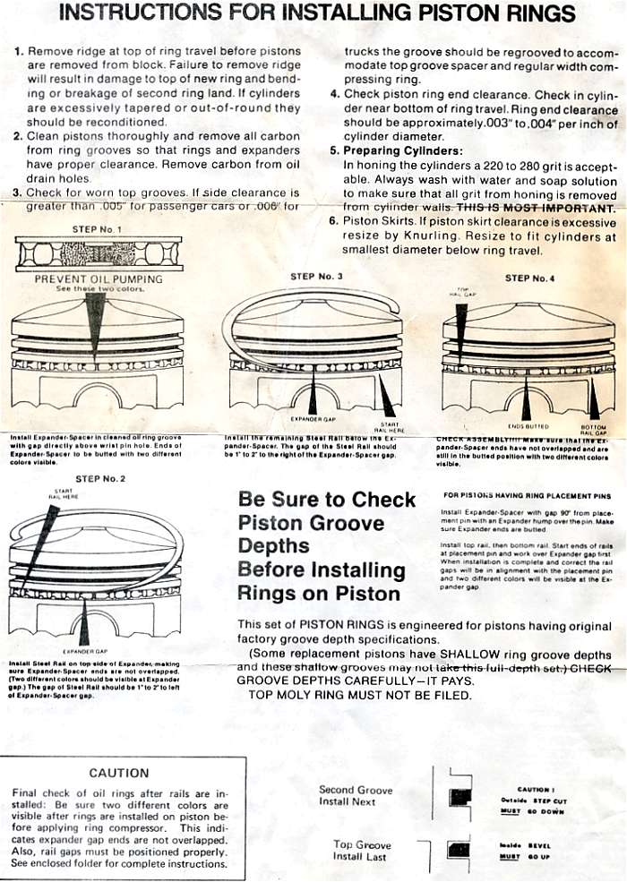

The ones I use have a bevel on the top, inner edge. Let us know what style you have.
Piston Ring Install Instructions
 Post subject: Mine are the same
PostPosted: Mon Dec 10, 2001 10:56 am
: The ones I use have a bevel on the top, inner
: edge. Let us know what style you have.
: DD
The top ring in beveled on the top inner edge and the second ring is beveled on the bottom inner edge.
Mike
