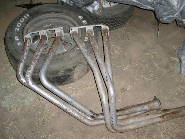

I have some Slant 6 Headers, and I heard that there were two different kinds made, car and truck, so i was wondering, how do I tell the difference?
From there, how difficult is it to swap the manifold to the headers? Does the intake come off?
Are there exhaust gaskets that I'd have to buy? What else would I need?
Any tips or other info is appreciated, thanks everyone.

What do they look like? Do you have any pic's?

They look like this:

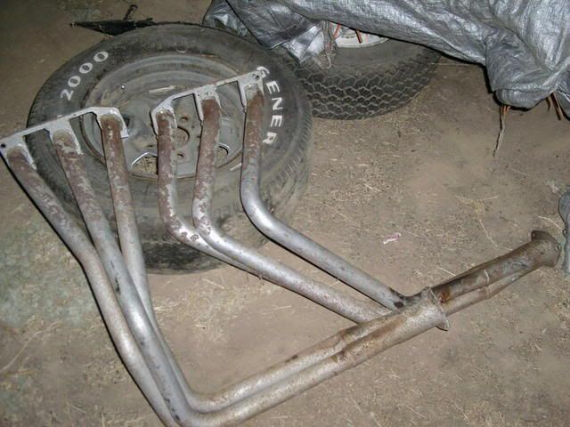

Or possibly like this:
The guy I got them from siad they were on his son's 63 Dart.

I'd say the first pic is correct the big bends are to clear the stater.

PostPosted: Mon Sep 22, 2008 5:41 am
Posts: 8977
Those are the "old" style Cliffords, for the 66 older "A" bodies. They are almost impossible to find. There were two different versions. One for the 225 engine, and one for the 170 engine. There is a small difference in the length, due to the difference in the hight of the engines. It is very hard to tell the difference, just by looking at them. If you don't use them, I would be interested in buying them.
That's what I figured.
Will either one work for my car? It has a 225 in it now.
You have to have the correct ones for the engine. They are most likely for the 225. The only 170 ones I have seen, are the ones Jack made for me, back in the '70's. I have seen 225 ones show up at swap meets and on line, so it seems like there were more of the 225 ones made. The only way to tell for sure is to try them.
