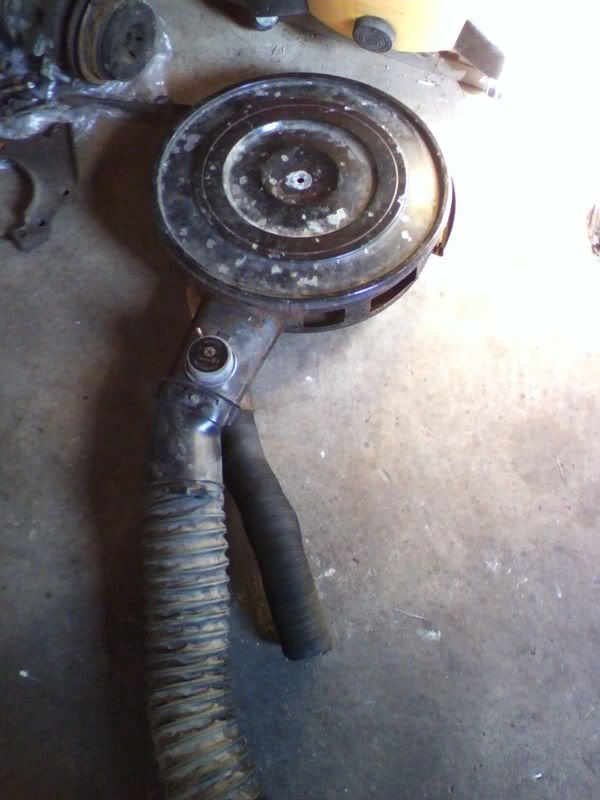

I managed to get a new 2bbl air cleaner off a later 318 on my trip to the ole bone yard today because I wanted the cold air intake. I had to take that stupid lean burn computer off (that was a pain), and I was wondering how I could block off that gaping hole(s) in the side? Any tips?

Go get a strip of sheet metal from the scrap bin at your local heating company... (if it's small enough, they might let you have it for free...)
You can then weld,rivit, etc the metal on and block the opening off...
if you have a buddy at said sheet metal shop... he can wire brush the paint off, and spot weld the metal on the cleaner, then you can paint after wards...

just spot weld some steel sheet metal like 1/8th you can cut it with a sheering tool and bend it by hand then sand blast the whole thing n paint it flat black?

Thanks, thats what I will do, and top it off with a nice super six decal. :D
