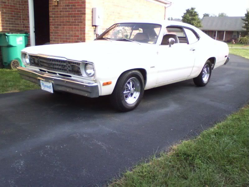

Has anyone noticed from my pics that my front wheels stick out more than my rear wheels? I had to put 1/8" spacers in the fromt because I kept snapping lug nuts, could that be the problem? My tires are 205/75R14 in the front and 195/75R14s in the rear (it was like that when I got it). Both rims are 14x6.

Front track on these cars is wider than the rear. It's normal. Snapping wheels studs is not normal and should be investigated. A spacer should not be needed to cure the wheel stud breakage.

It wasn't the studs, it was the lug nuts. The cragars were too close to the drums on the front and one of the nuts (usually the last one) would bind and snap the "shank" or what ever its called off. The wheel spacers solved that problem. The nuts would snap at 50 to 55 ft lbs.
