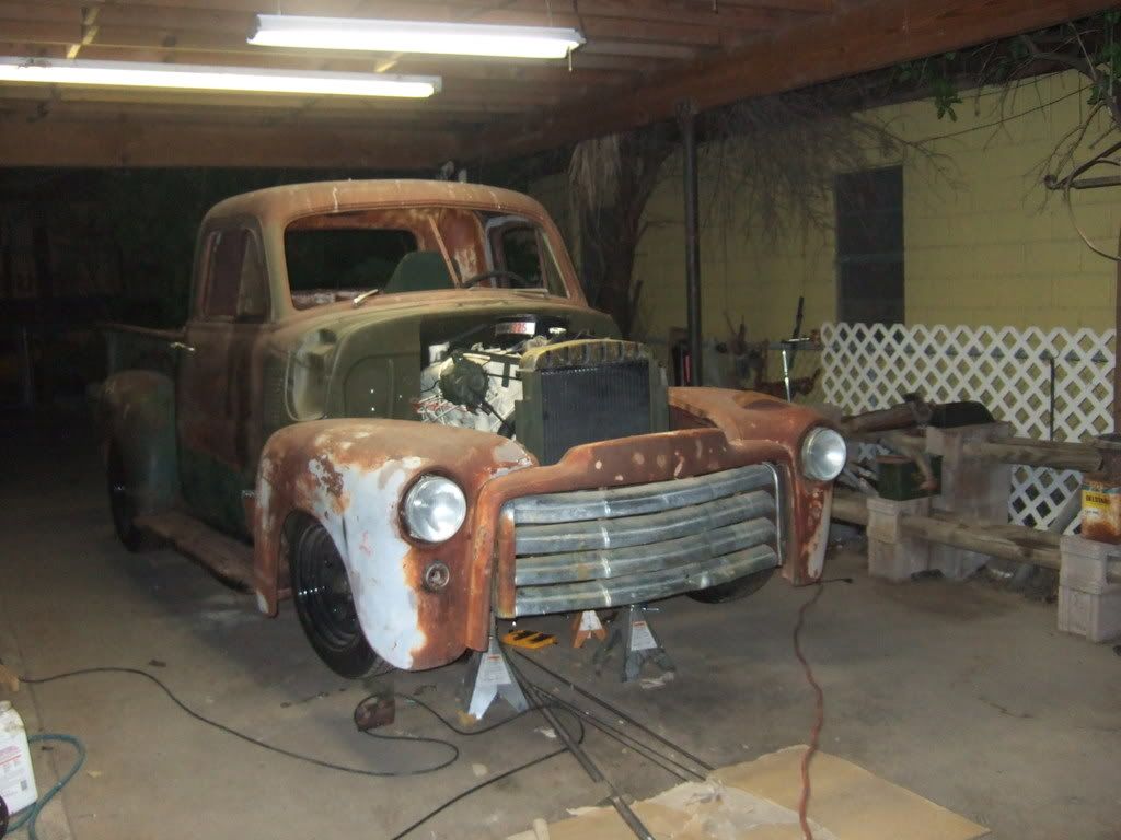

Ive always wanted a slant, Ive always wanted a 50s GMC. The engine is out of a 68 Dart, It runs great.

Wow. Very cool project. Make it weird and they will come...
Where are you located? Any chance you'll make a Slant race sometime?

Thats freak'n cool. You don't buy a look like that.....you earn it!

Nice...I like the paint job or lack thereof, kinda reminds me of an army truck without the white star 8) 8)

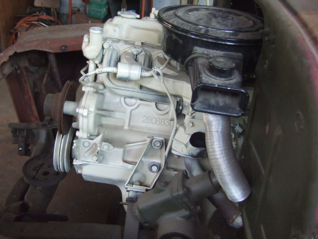

Cool! :cool: What transmission are you using? Did you modify the slant-6 alternator bracket to accept the Delco alternator, or did you use one of those Chrysler-to-Delco alternator bracket adaptors?

Where are the races held? The utilitarian, military look was what I was after, I covered the seats with duffel bags and will paint sections with olive drab but retaining most of the patina.

I went for the delco alternator after trying to get the chrysler to work, I like the single wire hook up of the delco. I used the stock upper bracket and fab up a lower bracket from some c channel I had. Image

Im using the stock tranny of the 68 Dart, the 904 I believe. Off topic, how do I resize the picture so they dont come out as large?

The alternator adaptor bracket I was talking about is this one.

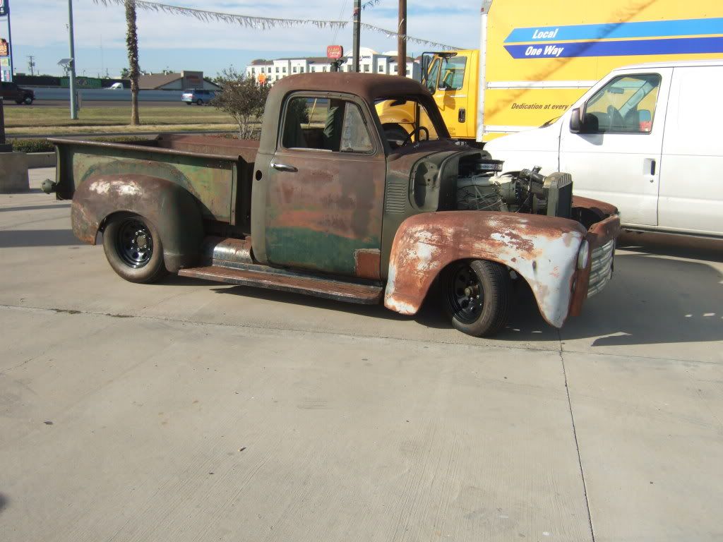

PostPosted: Wed Dec 31, 2008 3:04 am
Posts: 10401
There is a big rat rod / under constrcuion / patina rod movement around my area at the car shows in the summer. Pretty cool. Many of them look just like your truck.. the bad thing is that cars from around here dont have patina, they have rot.. I guess you need a SW vehicle to get the surface rust patina without the rot.

Hey it looks normal to me I have a 1973 slant with a 904 A from a Dart in my 56 Dodge truck other than some recent super six conversion problems I have been hot roddin' for three years with this combo and looking forward to may more!
1956 Dodge D100 Pick up
power plant 225 slant six

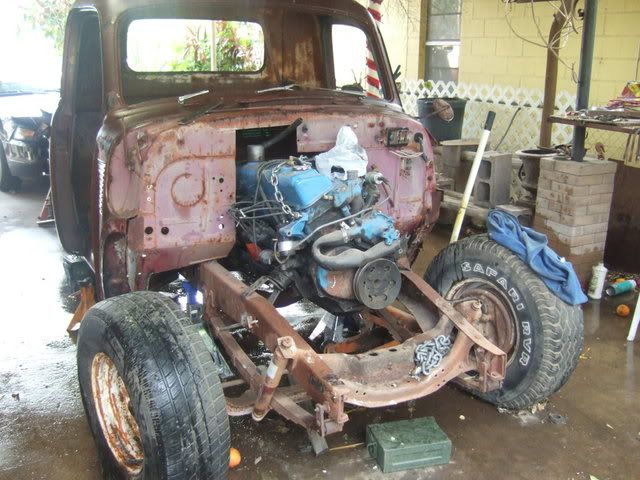

I would have never cut up an all original running truck. The cab and frame were bought for $50(I overpaid). The frame was on the ground, no tires or wheels, no engine, no doors, no glass, no bed, and had been this way for decades, and since I had the slant.....
