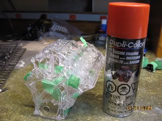

I'm building a 1/4 scale 426 Hemi model to display alongside my 1/4 scale slant six. I wanted to detail some of the clear parts with orange paint, but the Dupli Color Hemi Orange engine enamel I bought has metalflake in it. Is this correct for an engine, or were they a non metallic orange? I've never looked that close at a real Hemi and I could just paint it and say whatever, but now I'm curious. Anyone know?

Bummer. That's the paint (Chry Hemi orange) I bought for my 77 slant. I'll have to check now
PostPosted: Tue Feb 03, 2009 5:39 am
That's strange.
The hemi-orange paint I got (pretty sure it was duplicolor) wasn't metal flake....
PostPosted: Tue Feb 03, 2009 5:56 am
Posts: 2354
Race Hemi and Street Hemi are 2 different colors. Neither have metal flake.
My 198 is Street Hemi.

This is the stuff I bought, and it's definitely got metal flakes in it. I'll probably use it for something else, it's still nice paint - just not what I was expecting for an engine enamel. I'm thinking now that the correct paint would be Street Hemi Orange.

You can go to any Chysler or Dodge dealer and order the correct color. In the US I think it's $8 a can.
Order these numbers for:
P4349216 "Hemi Orange" '66-'71, '69 - '71 383 & 440 hi-pos, some '69 and all '70 - '71 340s, it's a reddish orange
P4120751 "Race Hemi Orange" '62- '64 413 & 426 Max wedge and '64 - '65 426 race Hemis, it's a bright orange

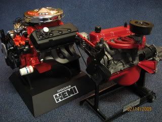

Here is my completed project just in time for Daytona! These engines are huge! :D
I did find some P4349216 "Hemi Orange" at the local Mopar Dealer, but It was too late to use on this model although I considered a last minute respray. I was afraid the Mopar stuff would lift the Testors enamel and I had already assembled some parts, so I guess i'll have it for the next time.
Can't wait to see the look on people's faces when they read about the Hyper Paks at Daytona. :shock:

I agree w/ you there, theres nothing "stock" about them anymore, I've lost interest over the years. I haven't watched a race in at least two.
Heres a link w/ some info on the race, they entered 7 cars and all 7 finished and of course, in the top 7 spots....
http://www.allpar.com/mopar/hyper-pak.html
I love the models by the way, I need to get me one of the slants.
