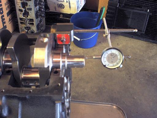

PostPosted: Thu Mar 12, 2009 10:03 am
Posts: 4880
Time to check the crankshaft "end-play" measurement.
Here is one of many webpages discribing the check:
http://members.rennlist.com/v1uhoh/cranksha.htm

I have that, and the info about the measuring is great, but I have no flywheel on the end of the motor. how else would I check, or is it beyond checking.
PostPosted: Thu Mar 12, 2009 10:46 am
Posts: 4880
Use the rear crank flange or the flex plate.
I use a dial indicator with a magnetic base and can set that onto either end of the crank to do the check.
PostPosted: Thu Mar 12, 2009 10:53 am
Posts: 17458
I advise you not to tear your engine apart just because of this. Just check endplay and reinstall the damper. 999/1000 times you will not hurt the thrust bearing, is my estimation.
