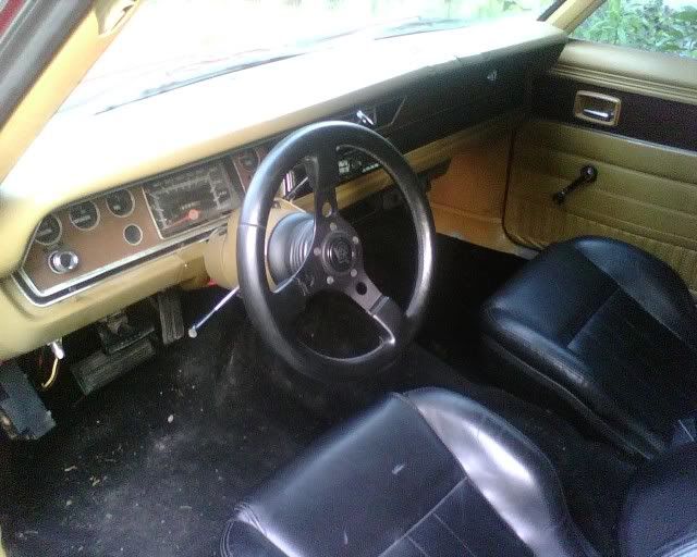

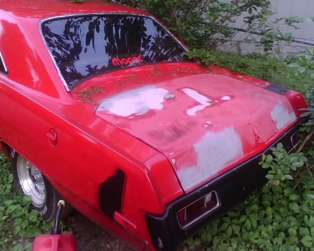

i have a 73 scamp that is in amazing condition for how much i paid for it but it wont start
when i decided to buy hte car(from a neighboor) it started easy and even on a push button
well 3 weeks later and its outta gas and i have the money..
now it wont start!
oput gas in it and it wont even run off starting fluid
put new plugs in it and when gapped at.020 it gets little spark and none at .035
well we're thinking its the coil but we arent positive
were hoping its not the pickup in the distributor!
any suggestions on what to try?
i had to go out and get a multimeter since my last one broke and we quit for the evening afterwards
and a real dumb question
whats the oil capacity of my 73 sl6?
heres my new ride....one of many i spose
and for kickers..heres my project
