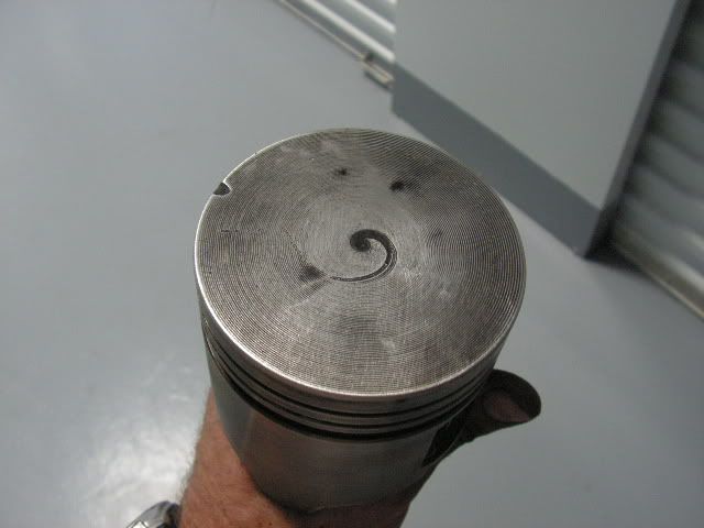

Got a quick question once I dissassembled my '76 225 for a rebuild and got her all cleaned up and noticed a strange gouge (?) in the #2 piston Image so should I be worried ? I checked the valves, non of them are chipped of gouged and spin freely with springs removed.

Looks to me like the manufacturer added that "feature" when the top of the new piston was machined.
I can hear the machinest now... "that wont hurt anything, it's good". :shock: :roll:

That one spiral gouge is typical of worn out automatic machining mechanism that failed to retract cutter correctly after facing the top of piston.
Run it.

really zilla, WoW not lol, but how much deck is available on stock pistons ? Is it better to have glass smooth tops on the pistons or those "rings" that are machined ok to have ?

I would not worry about marks in the piston tops as long as long as they are not too deep. :D

maybe try to get another piston if your worried about it? :?
I would. :lol:
