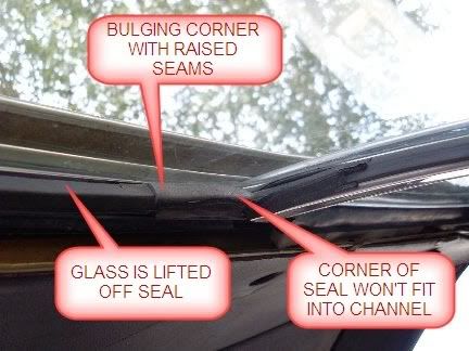

Have any of you used Metro brand (in the purple packaging) roof rail seals on a '74 Duster or Dart Sport? If so, I really need your honest opinion about how well they fit and seal off your windows. About three years ago, we tried to install new seals on Aaron's '74 Dart Sport. They were obviously molded differently than the OEM seals, and we never could get them to fit correctly and seal off properly. We ended up setting them aside (lost now in the clutter) and re-used the old original seals.

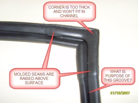

I recently bought another set of new roof rail seals from Metro, and it's like deja vu all over again. Aaron and I fought these for about an hour and gave up, frustrated. Because of the way they are molded, the 90* corner at the top of the door window/quarter window interface is too bulky. It's impossible to get all the mass of rubber pressed tightly into the corner. It bulges out so much in the corner that the glass is lifted away from the seal for much of its length along the roof rail, allowing wind and water to get in.
Along the vertical piece that presses into the stainless quarter window frame, the original seal was molded in a single smooth surface (maybe an extrusion). However, the new seal has a separate molded "flap" or "groove". I don't believe the intent is for the glass to slide under the flap, because it would eventually get frayed and torn from wear as the door is opened and close with the window rolled up.
The long and the short of it is I want to visit with Metro's new product manager and explain the problem to him. I don't believe it is a window adjustment issue, I just don't think anyone has bothered to let them know there is a problem. Maybe I'm just all wet. That's why I need to hear from any of you who can say, without reservation, that their seals worked correctly in your application.

I have almost the same problem and I have the metro kit as well. I had better luck with getting the corners into the rail (although it did buldge out a tiny bit) but the window didn't even touch the weather stripping along the top roof rail. Even with it like that, I couldn't roll the window up with the door closed because it just catches the molding that goes down the quarter window and starts folding it backward. If you jack the door up and in to seal off the top, it just makes it even worse when trying to roll the window up. Actually it's impossible. If you move the door out to let the window roll up without catching, then you can basically stick your finger through the gap at the top of the window. It's frustrating and I just put my old weather stripping back in.

ESP47, thanks for pointing that out about difficulty rolling up the window. I didn't mention that, but it is another problem I am having as well. The glass grips the rubber rather than slide across it.

I'm wondering if it may just be the way were installing it. I don't know if you had to put your old seal back on like I did, but when I put the old seal on, I could no longer roll the window up without it gripping the rubber and trying to get under it instead of just sliding up against it. Since it's my DD I just adjusted the door so it's pressed further in against the cab and I only roll the window up and down with the door open. I'll have to keep it like that until the rainy season ends and I can really get to work on it without having to worry about having it seal perfectly the next day. If you find out how to fix this problem then please let me know. I have an entire box of weather stripping here that I'm pretty ticked off about.
