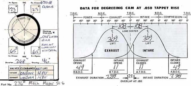

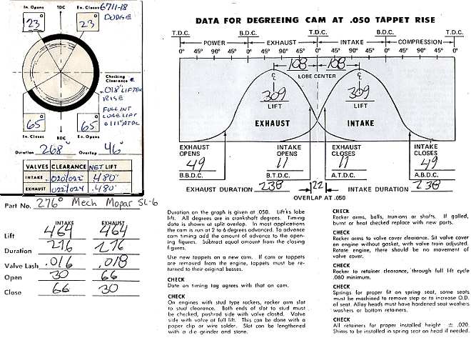

 Post subject: Re: Cam Cards *PIC*
PostPosted: Thu Jun 13, 2002 10:25 pm
Great idea on the cam cards, here are a couple I scanned-in. Always keep these cards for the cam(s) you get / put in your engine(s)
There are 2 cam cards shown here.
The bigger "camel hump" graph is for the Clifford 276º mechanical cam, the smaller card I inserted in the left corner is a custom grind I worked up with a local grinder.
Note that the Clifford cam measurments are taken at .050 lift.
Both of these cams are "even pattern" with the overlap event evenly split or centered over TDC Exhaust.
Larger full page view (big file size)

You know I can't recall ever seeing the Cartesian coordinate(camel-hump) graph before. I think it's even easier to understand than the other. Thanks, Doc.
: Great idea on the cam cards, here are a couple
: I scanned-in. Always keep these cards for
: the cam(s) you get / put in your engine(s)
: There are 2 cam cards shown here.
: The bigger "camel hump" graph is for
: the Clifford 276º mechanical cam, the
: smaller card I inserted in the left corner
: is a custom grind I worked up with a local
: grinder.
: Note that the Clifford cam measurments are
: taken at .050 lift.
: Both of these cams are "even pattern"
: with the overlap event evenly split or
: centered over TDC Exhaust.
: DD
