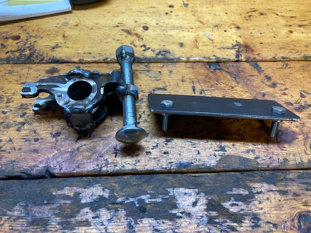

This is what I came up with to remove the valve springs with the cylinder head on the crankcase.
How you keep the valves up is up to you, I am thinking the 'rope in the cylinder and the piston pushing up'.
this trick has two stock rockers with each of the rocker arm side spacers trimmed.
I set these close together as I am using it to work with beehive springs and retainers.
Photos are of a bench test, and it worked really well.
I went with a jack screw design, that allows one to compress the spring and have the screw hold the compression with out holding a lever.
The lower base supports the jack screw. Used two 7/16 bolts - nuts. Filed the 7/16 nuts to make them a snap fit into the cylinder head bolt holes.
Used a carriage bolt as the pivot point as the angle of the rocker arm changes as the spring is compressed. The radiused head of the carriage bolt
sets against the rocker rail and is fully supported.

PostPosted: Mon Dec 13, 2021 7:47 pm
with ratchet
