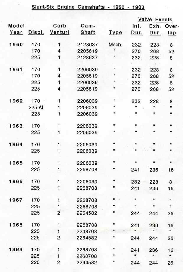

I am under the thinking that a SL6 would like more lift on the intake valve.(more flow without the reversion effect the longer duration will introduce)
Here is a chart on SL6 cams to review, the factory did put less duration on the exhaust side but I do not know why. Does anyone know?

I've often wondered not only why they did that (difference in valve sizes intake/exhaust??) but also why they *stopped* doing it with the '71 cam. Looks like installing the high-lift rockers on the intakes would get back to that "dual pattern" (terminology?) arrangement used by the factory in the earlier cams, but with the longer duration and higher lift of the later cam. In *theory*, I guess it should run pretty well, eh!

i think the basic theory on the exhaust lift is that the exiting gas will be a lower density than the intake charge which also explains the smaller valve on the exhaust side. dual pattern cams tend to make good power and run fairly smooth. the 340 faactory cams had a higher lift/duration on the exhaust to give them that "rumpety-rump!" sound. ahh, thank you mr. marketing man!
-james
