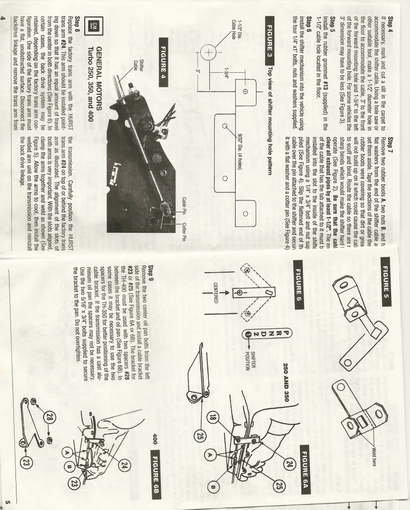

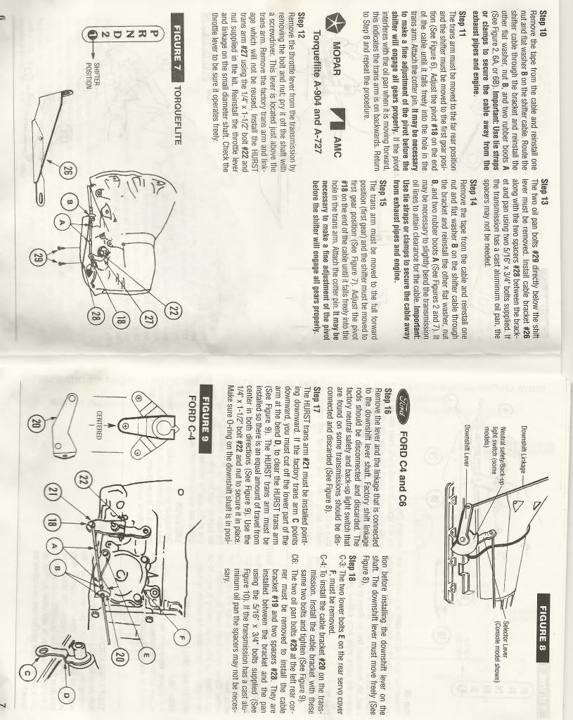

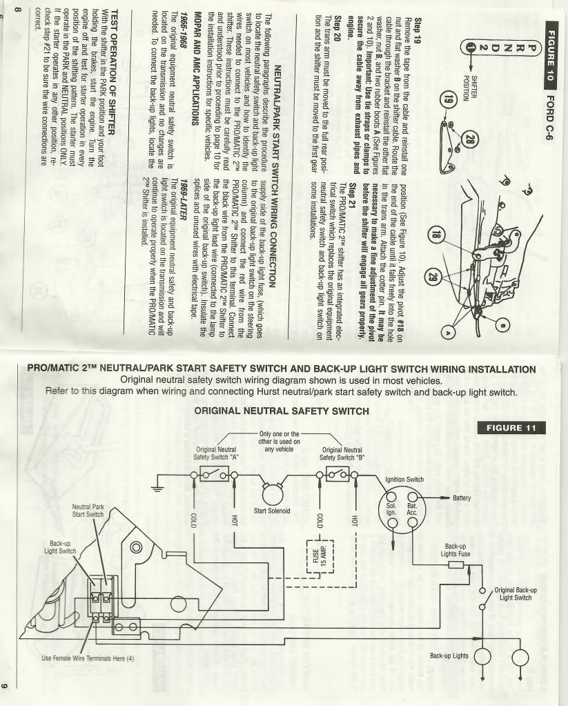

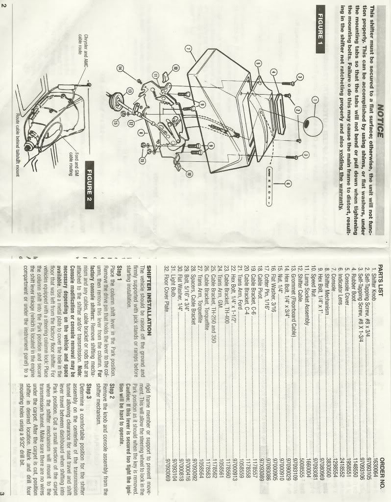

Here are the instructions. I have one I am planning on installing just have not got there yet. hope it helps
1964 barracuda 198 slant
