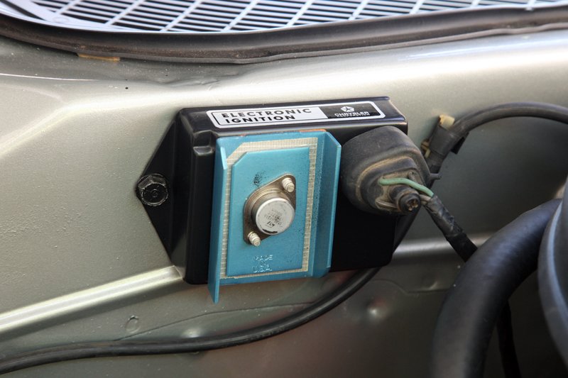

Welcome on the board. The ignition module is not located inside the distributor. It's bolted onto the firewall or inner fender and looks like this:
(colour of the box may vary). A good replacement module is Standard-BlueStreak #LX101.
The part inside the distributor that occasionally(!) goes bad is the pickup assembly.
What diagnosis have you done to determine which part (or parts) need replacement?
