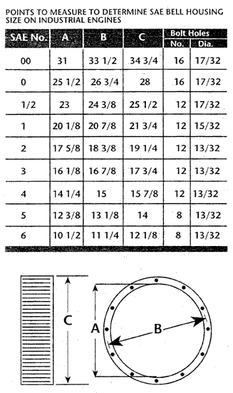

I'm wondering if these were ever available for the slant, but it seems likely considering the number of marine and industrial slants built. Anyone know if they were ever made? Anybody have a line on a good industrial equipment wrecker?
I'm considering how feasible it would be to direct mount a generator head to a slant and and SAE bellhousing would make this very easy.
Thanks!
