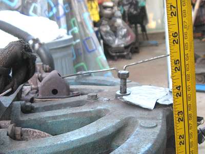

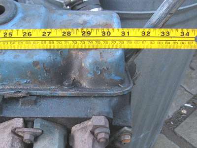

Can someone please tell me what is the overall length, Minus Fan and Width of the slant six?
I want to swap a Slant into a little car and need to know if it will Fit... It's characteristics & fit that Im looking for in an engine and I would like to clean the clocks of various SB chevy and Ford freaks

Roughly 22" Wide and 32" Long with the fan on it. You'll save maybe three inches without the fan if your still carrying the water pump up front. It sticks out quite a ways.
Now its only fair. Tell us what your planning to bolt it into! :D

You guys are awesome... measurement from the back of the stock block to the grill is 30" Major firewall Modification 8 inches and it could fit with the stock radiator location... Was going to sh*tcan the idea until all you got your two cents in. It would be fun and Race wieghts could be sub 2000lbs Intended it to be a Race car so what the hay Stuff a 8 3/4 in the rear and it will haul
