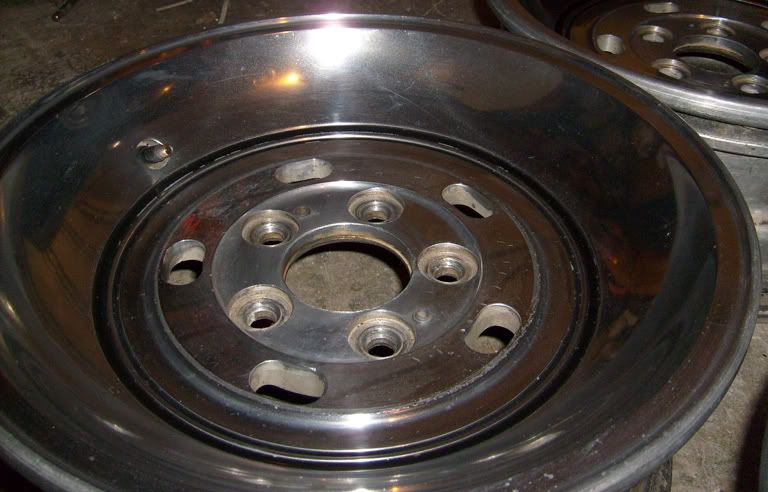

I have a set of the somewhat rare late 70s Chrysler aluminum rims that came on Cordobas and LeBarons.
I want to put them on my newly acquired 83 van, but I have two questions.
First, what is the proper style of lugnut and washer to use with these rims? They are a factory rim and the lugnut holes in the rims are tapered, suggesting that the stock acorn style lugnut would work. True? Do I need a washer or a lugnut with a shank?

Yes, you want tapered seat lug nuts, but I like the bulge seat 13/16" hex ones rather than the more common 3/4" hex nuts. The bulge seat resists pull-through better and usually keeps the socket/lug wrench from contacting the wheel.

I think the bulge seat lug nut has a flare just above where the nut tapers. Regular acorn nut is straight then tapers.
Those cleaned up really nice! One idea: Use some JB weld and fill the holes that the support bracked bolted in to, then paint the centers where the lug nuts go black. You may have to scuff up the wheels to do this but the paint will stick better. Just an idea. Those will look really good on the van! 8)

Thanks guys! The pictures make them look better than they really are. I bought them from a guy who had them on a Toyota pickup. The rims are covered with little pockmarks from rocks and other road debris. They really could use a professional polishing job with sandpaper and the whole nine yards, but that's not going to happen.
