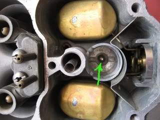

The arrow points to the "intake check ball" (the ball bearing underneath the plunger):
This was missing in Carb 1. Presumably, the purpose of this is to keep fuel from entering the hole beneath the plunger, as the plunger goes down? It must be there for a reason, so. . .
Q4: What might happen if this ball is not in place?

Hi fab64. What happens if the ball is not in place: nothing! You'll just push the fuel back, the ball's job is to shut off the possibility for the fuel to run back to where it came from! Pushing 'the pedal to the metal' only makes a 'clonck!'. The fuel that is in that chamber, is the volume of fuel intended to spray into the airstream in your carb when pressing the accellerator pedal, if it is not there, you will experience the worst bog ever.
The BB in Carter BBD also stands for ball and ball, and they're there for a reason. The 8087S is found on page 44 in manual 1 below, '77 Aspen/Volare supersix, same as my carb! 8)
See the carb FAQ at the beginning of the engine section, for jet numbers and metering rod sizes, see this link, you may find the answers to some of the questions you have there.

Before putting Carb 1 on my car in January 2009, I re-built it. At that time, I didn't find an intake check ball, so I put it back together without one. It ran great, and didn't have any problems (other than poor gas mileage) for about a year. I then switched to Carb 2 about two months ago, and haven't been able to get it to run right.
Today, I swapped the main jets and venturi screws from Carb 2 to Carb 1, and also put the intake check ball from Carb 2 into Carb 1. It started and ran very smoothly, but would bog down whenever I tried to accelerate.

Then I wondered if it might be the check ball I installed. I finally located the repair kit instructions, and they say: "Check balls must be installed in their proper locations. Failure to do so will cause hard starting and/or inability to accelerate". This seemed contradictory since, as I said, mine never had one in the first place. So I took it back out. No change.
