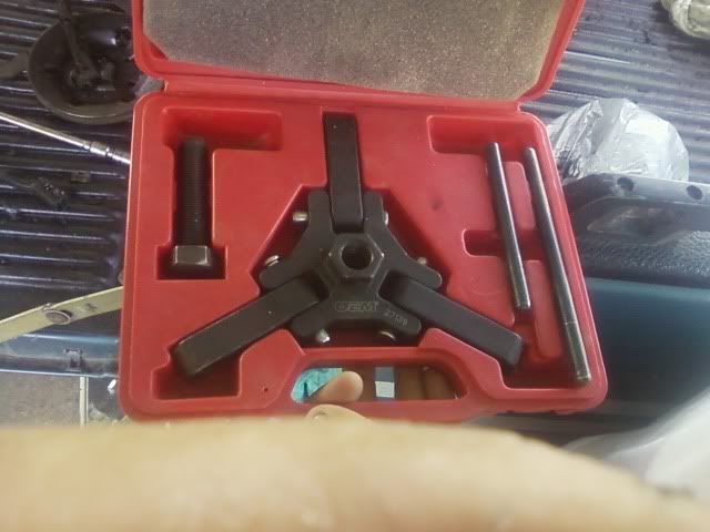

we tried using this puller from autozone, didnt even fit. n e one know wat tool exactly
<a href="http://s20.photobucket.com/albums/b231/usbaldo/?action=view&current=untitled-5.jpg" target="_blank"><img src="http://i20.photobucket.com/albums/b231/usbaldo/untitled-5.jpg" border="0" alt="Photobucket"></a>

The tool you are looking for looks like this

yea my dad has that one and tried it. it didnt want to come out tho.....
