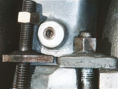

Measure the thickness of the intake and exhaust manifold flanges where they are machined for the triangular washers. The intake should be a little thicker than the exhaust so it has more clamping load. It could be that the intake has been surfaced a couple times and is thinner than the exhaust manifold. Also, the manifold shouldn't be any more than .008" from flat. Further, the two manifolds need to be bolted together loosely until the manifolds are tight to the head.

Yes, I was concerned about the manifold not being able to float when I torqued up to 15 ft/lbs but I was desperate. :oops:
Now a DUMB question......
I don't understand the triangle washers. I was told to install with the dimple out (facing the nut). All I am installing is a regular nut here. It seems there isn't much 'meat' for the nut to grip when torqued.
Should the dimple face the head leaving the flat surface for the nut to grab?

dimple out
take manifolds apart ..exhast needs to be thinner than intake

Apparently there are slight dimensional differences between the old exhaust manifold and the new one.
Enlarged all three mounting holes in the intake by quite a bit to get the flanges to line up correctly. Looks much better with a straightedge on it now but will still wait for the RemFlex gaskets to come in that I ordered today.
I placed the intake manifold back on the old exhaust manifold for a test fit and it lined up perfectly before I enlarged the holes. Not sure why the exhaust manifold dimensions are slightly different?????
Also the intake flanges are the same thickness (or even slightly thinner) as the exhaust flanges. It has probably been machined in the past.
