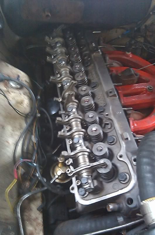

the compression in my 62 dodge lancer is reaaallly bad, around 30-60-90-120-60-125. it's causing issues with my starting. i'm currently looking for a good shop that won't charge an arm and a leg for a head rebuild. JUST the head, she's running clean, no blue smoke/ring warnings, etc.
i've talked to central cylinder head, they quoted me $180 top end price for the job. this is FAR better pricing than the other two places i checked, but i've been getting mixed reviews on their work. jay at jay's garage swears by them and says he has been taking work to them for 25 years. another friend says he's heard nothing good about them, they just do the bare minimum and no guarantee, with bad results. i trust both these fella's opinions.

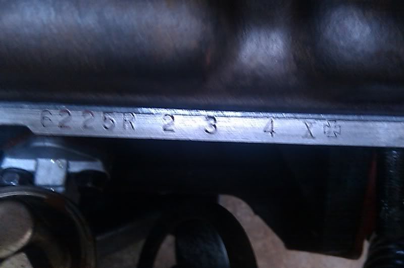

so josh, matt, MM's: took your advice and my better judgment, got that valve head into portland engine rebuilders, $486.85 later,
mark brought my attention to the iron cross in the stamp. what's that all about? and many thanks to mark for doing all this work on my poor girl. he did my brakes first, so the new compression should not be too much for them. :)

I once had a 68 motor with the maltese cross. The maltese cross was one of several marks put on the block at the factory to denote some variation from the stock measurements. On the 68 motor it meant the crank journals were .010 undersize from the factory. I believe it meant other things in other years. They were put on as part of the quality control process at the engine plant. I know the X means something too, but I can't remember what. Get a factory service manual for the year of the motor and look it up in the engine specifications section.

from mark:
Means you have Jen u wine HOTROD! seriously it means the crank bearings are non standard size.
which i translate to mean...after this head rebuild, she's going to kick some dirt! i seriously cannot wait. this is the last big thing. then on to leaf springs and front end alignment, but at least she'll start and stop now, haha!

A Maltese Cross means undersize crank journals and bearings. The X is a roman numeral and indicates .010" undersize.

Other Stampings
Additional stampings may be found on the ID pad.
They identify non standard engine components.
A - .020 oversize cylinder bores
Diamond - oversize tappets
E - Cast Crankshaft
HP - High Performance
L or LC - low compression
M - .001 undersize main bearing journals
Maltese Cross - .001" undersized bearing shells
Maltese Cross and an X - .010" undersized crankshaft
O.S. - .005 oversize valve stems
P - premium fuel
R - regular fuel
RX or MX - all main or rod journals .010" undersized
S - special engine
WT or TW - water test
X - .010" undersize crankshaft
