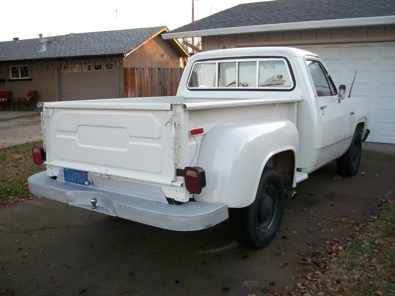

Hey guys, I've never towed anything before but I've been looking into buying a cheap parts car for some parts I need. I have a 78 D100 with a 2bbl slant and 3 on the tree. The trailer ball is on the bumper. I'd like to use one of these if possible.
http://www.uhaul.com/Reservations/Equip ... x?model=TD
But if I had to I'd like to be capable of using a full trailer so the rear wheels aren't rolling. I'm guessing that I definitely wont be able to use the hitch on the bumper right? If I relocate it will the truck be enough to use both trailers or just the first one?

Its cheaper to just get your parts car towed .
The bumper hitch is good for about a 2000lb trailer....
Any vehicle towed on a dolly needs plates in many jusrisdictions.
I wont tow a car without a trailer that has trailer brakes......around here any trailer over 3500lbs has to have brakes.
The cost of the brake controller and wiring would get your parts car professionally delivered.....

Class III hitch and brake controller will set you back $300 easy.
I won't pull a trailer w/o brakes either. It's just too risky in this sue happy society.
